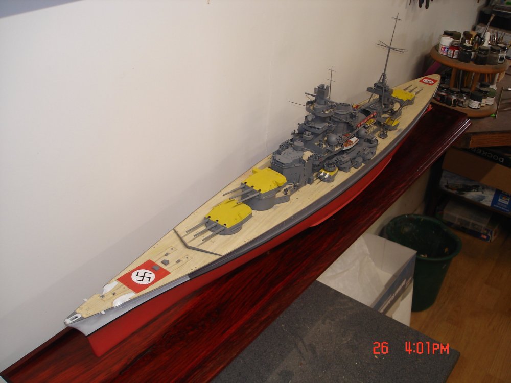

Scharnhorst Kreigsmarine-Trumpter-1/200-Operation Paderborn

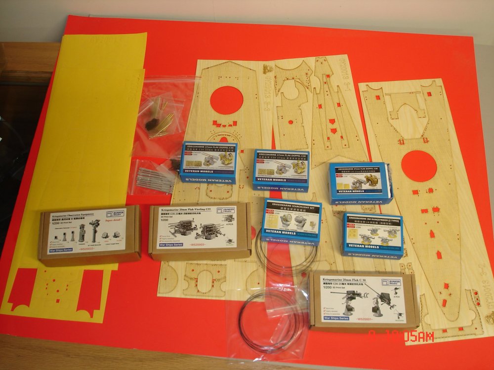

Time to resurrect this build now the Mk-24 is complete going to be photo heavy guys and using an outside server for pics since they are stored there in order methinks should be.๐Ÿ‘
The START of some AM๐Ÿ™ƒ

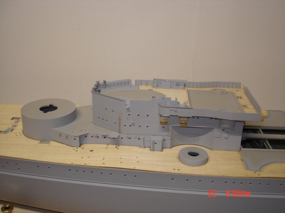

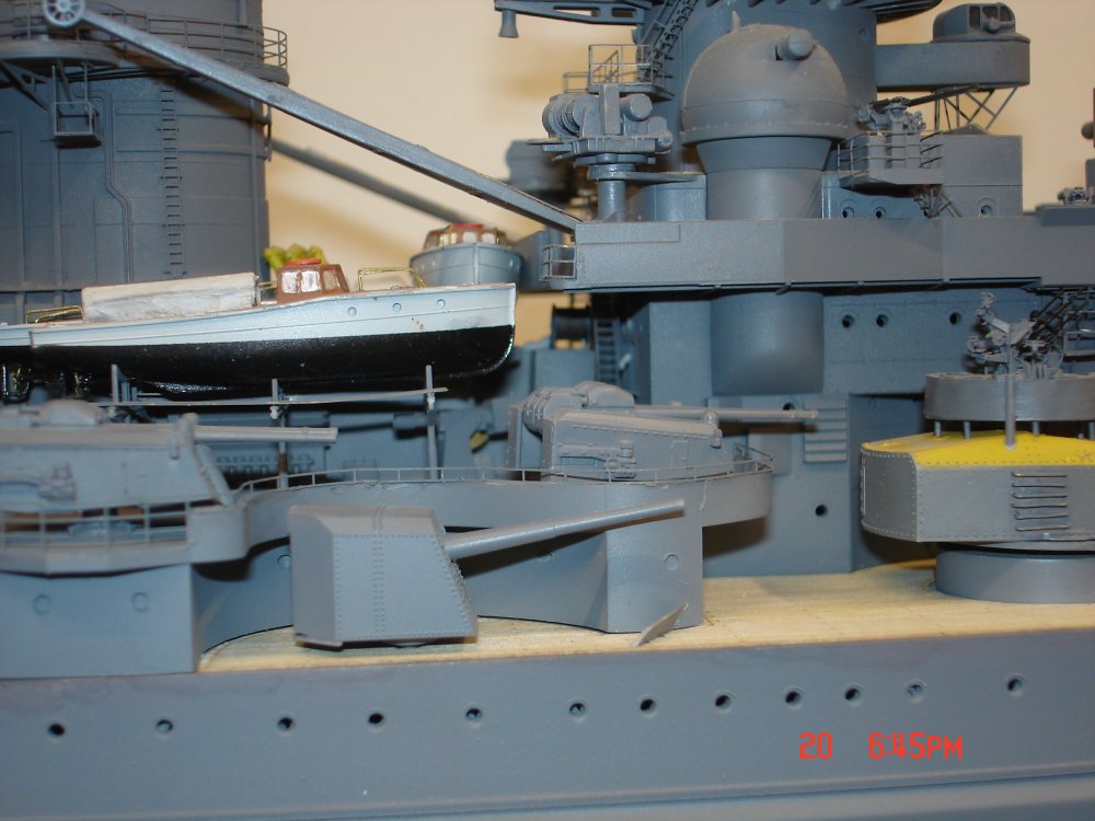

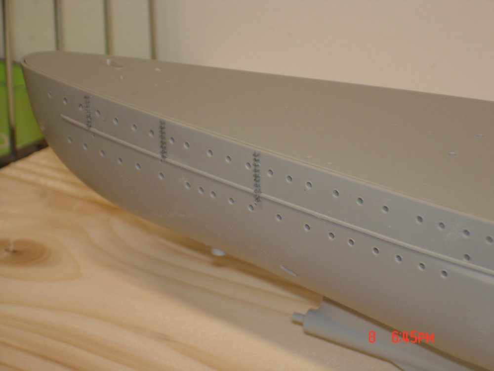

The porthole were all drilled and exterior ladders installed these were 1/350 for IJN in that scale measure 24" across 18" in 1/200 and KM were narrow by pics.

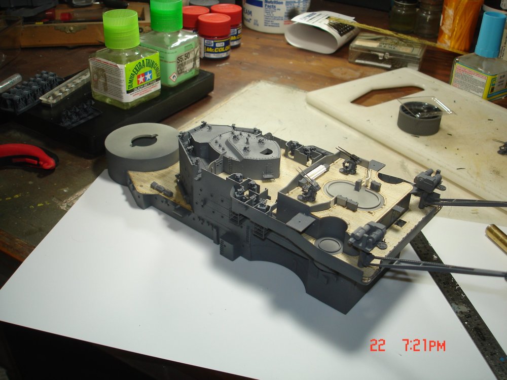

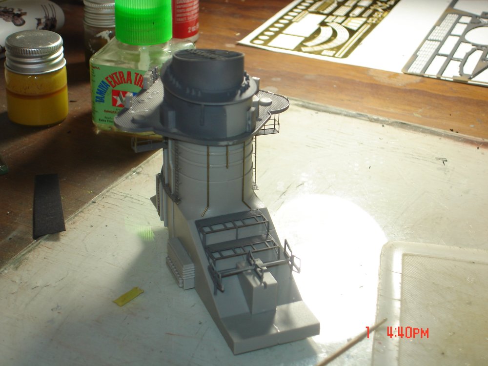

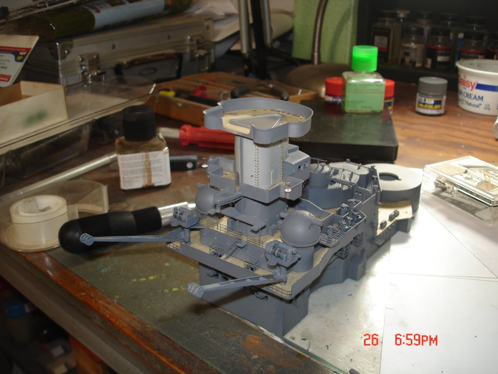

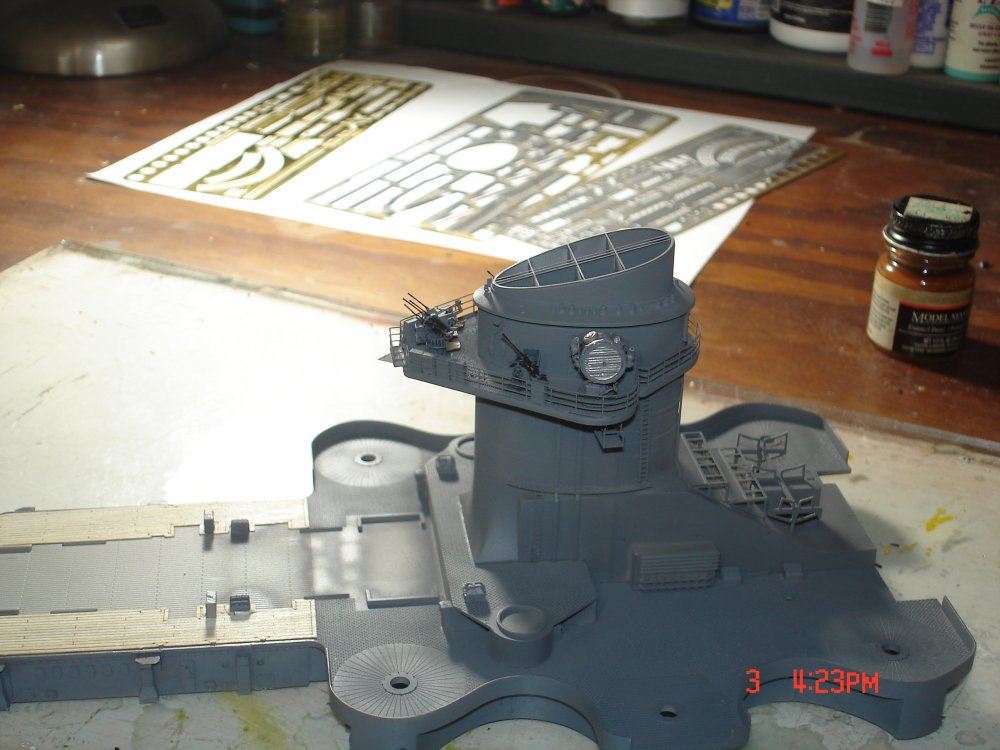

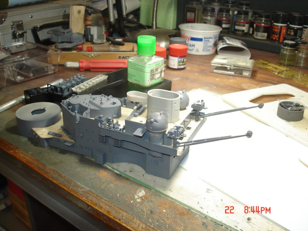

Starting to add some PE to the SS.
You can see some railing being added to front of the SS at this point PE evaporated from Chikuma and I am now making them out of .015". brass wire tweezers narrowed to correct with bent and cut looks better being round over flat
scharnhorst 003.JPGE

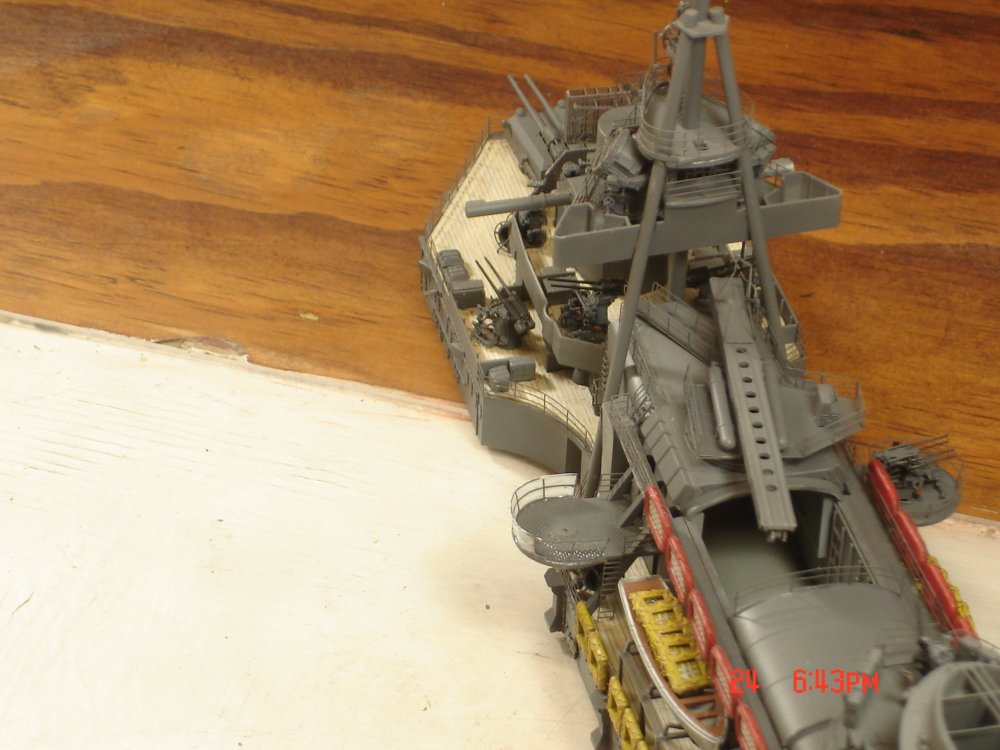

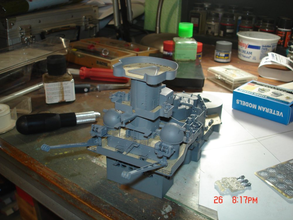

More PE and binoculars these are 3D print now the build price/quality starts going up I am now will over $1K on the build.I have invested heavily in 3D from this point out I still used some Veteran Models stuff a mix of resin/PE small tiny and time consuming.

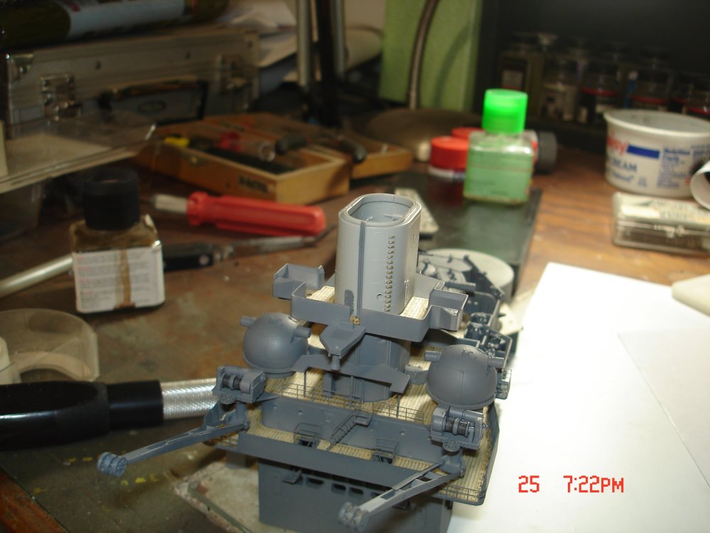

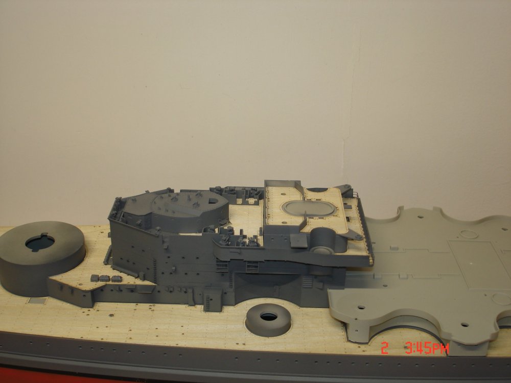

This needed modification for Operation Paderborn I believe a directory for the forward guns

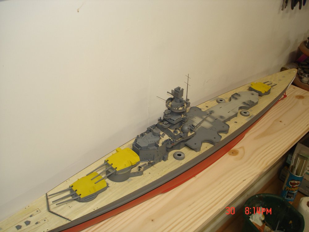

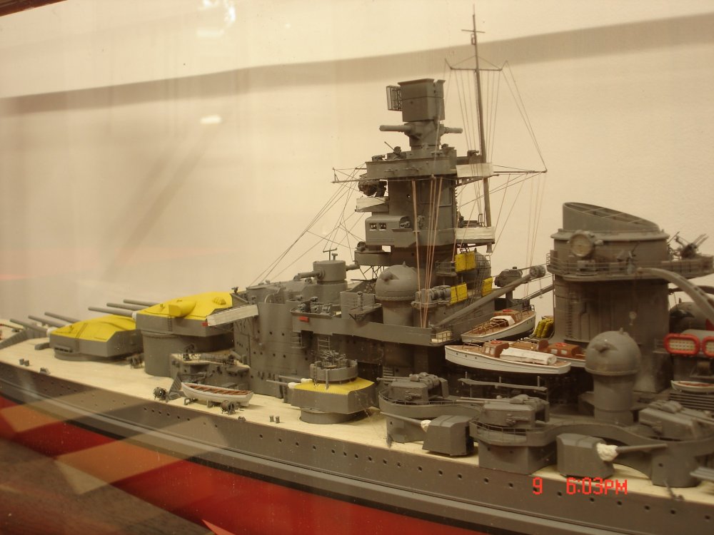

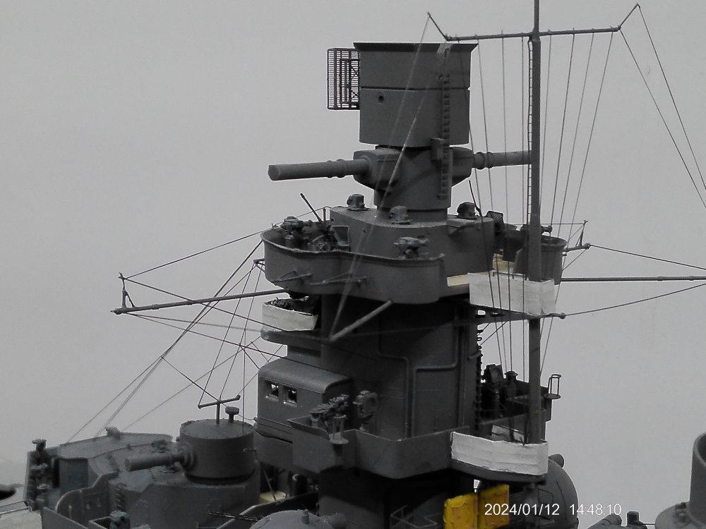

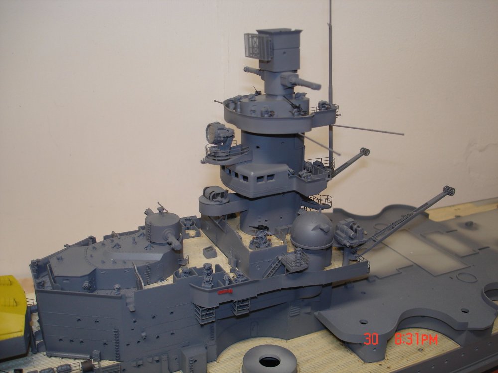

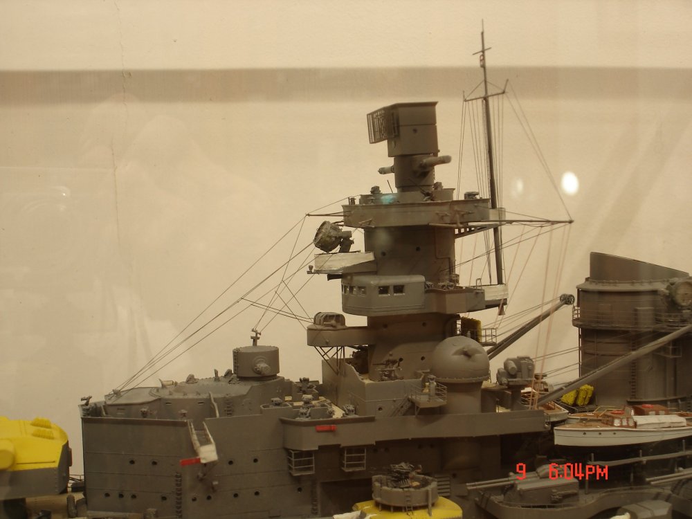

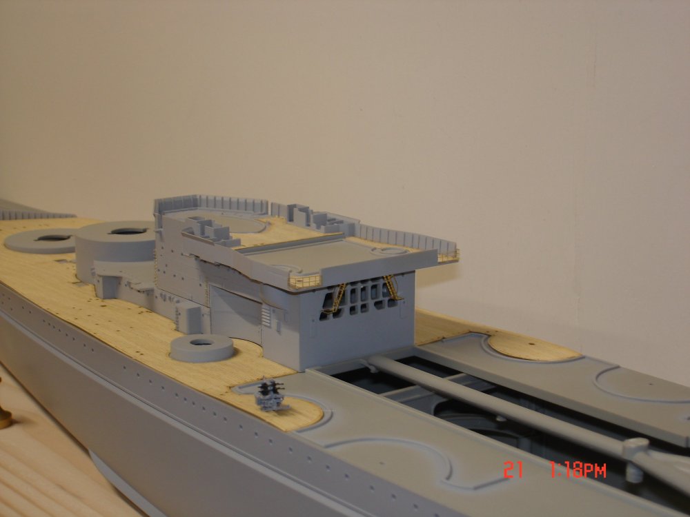

Some paint being laid now RLM66 this is the observation deck/lookout my one major flaw in the build this is the Gneisenau design why Trumpter did not make that one piece to fix the ship to fix it if it failed was to much of a loss at this point so she stayed.
I should of studied just a tad more I am not the only a French builder did a beautiful build which inspired me he just did catch the mistake

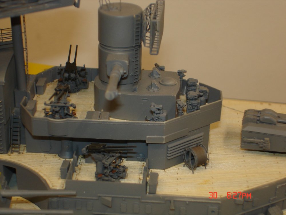

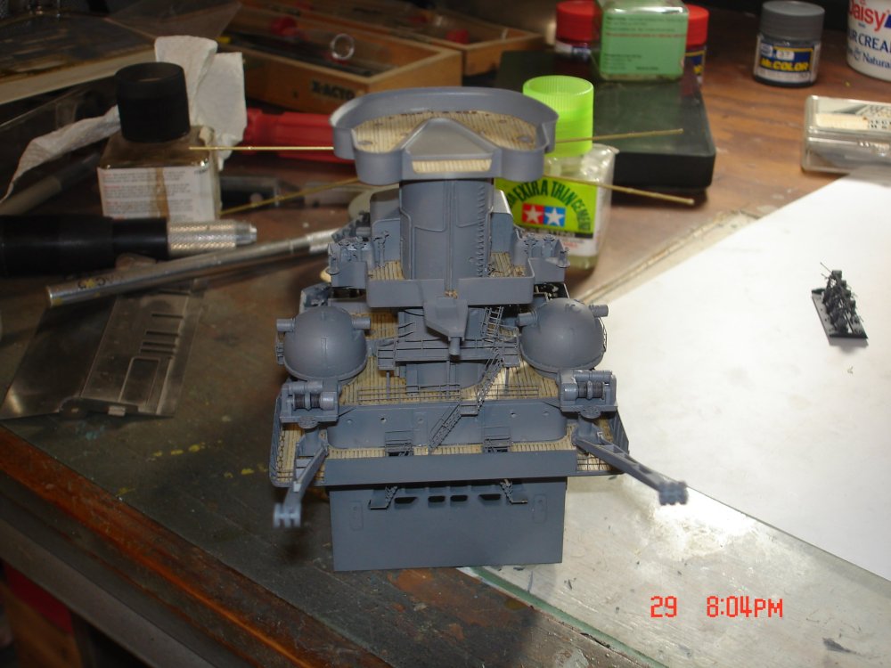

SS coming together I think these are the Veteran Models guns they got replaced later down the line with Bunker Studios.

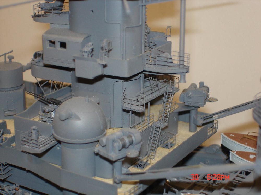

More ladders ladders everywhere some Trumpter did not even start to mimic but the ship had many lives and refits.

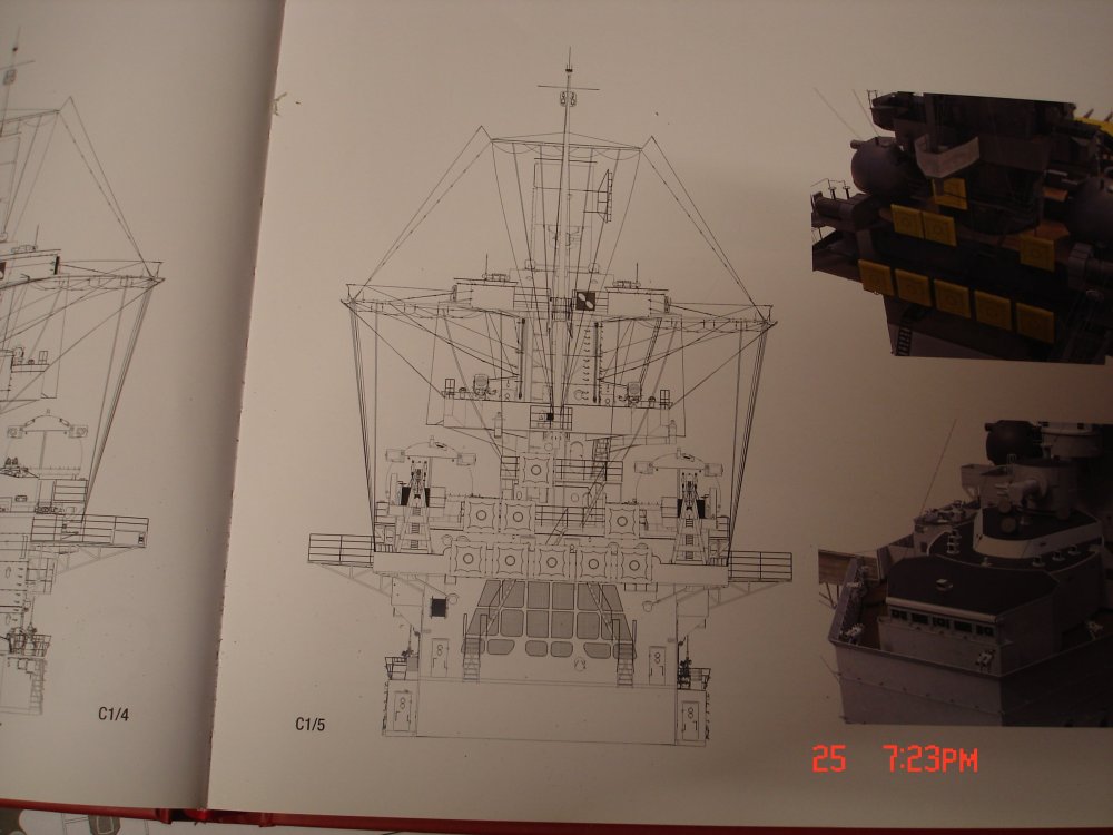

The books are called "The Anatomy of (whatever ship) Sharnhorst"this indispensable Paderborn March1943

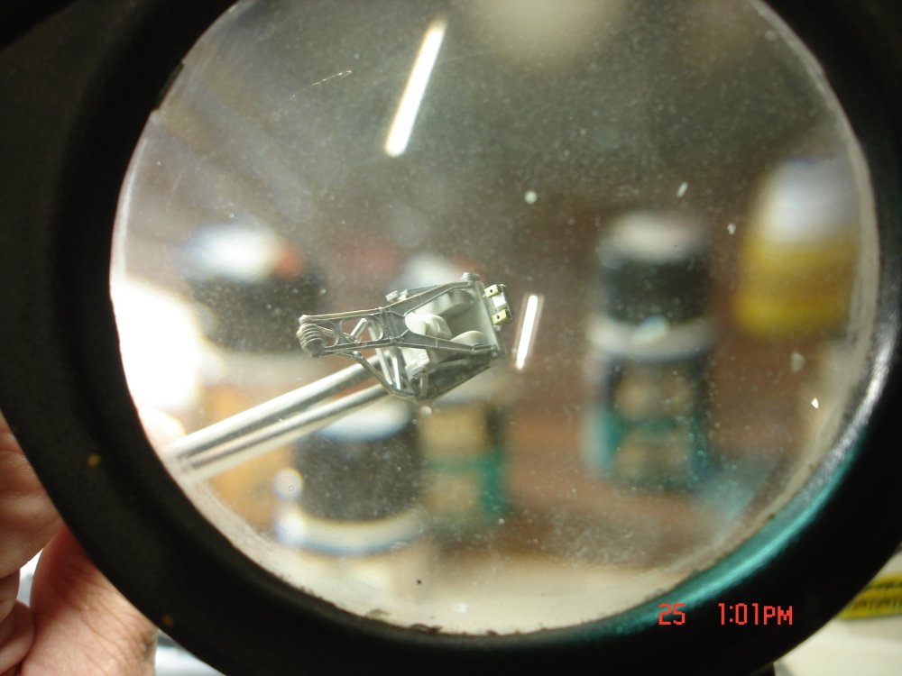

I do not remember the exact number of parts but it was 15/18 like just for that searchlight and I had to do three now these are Veteran Models highly recommend.She look'in good.๐Ÿ˜€

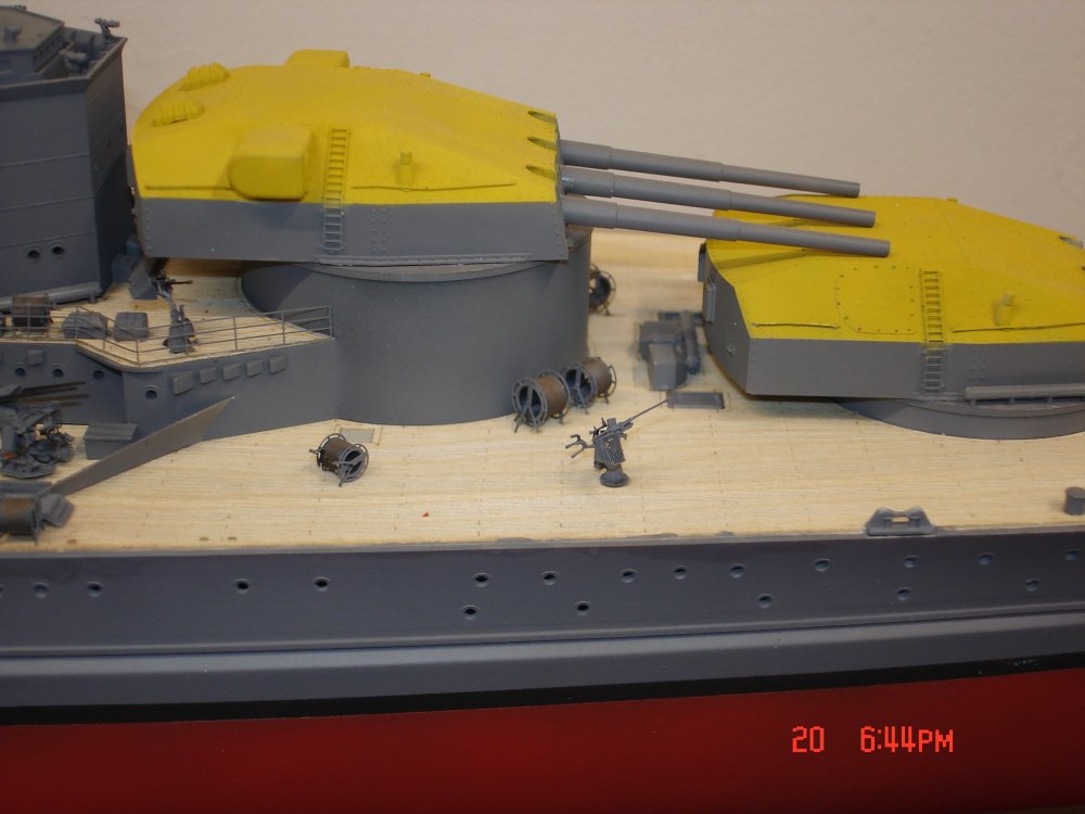

These did not even exist in the kit and are not finished looking at the pics their was 2/3 different 40MM Flakvierling used at different locations seats changed and their position within the gun Bunker Studios came to rescue having each type in a beautiful delicate rendering.Recommend!!

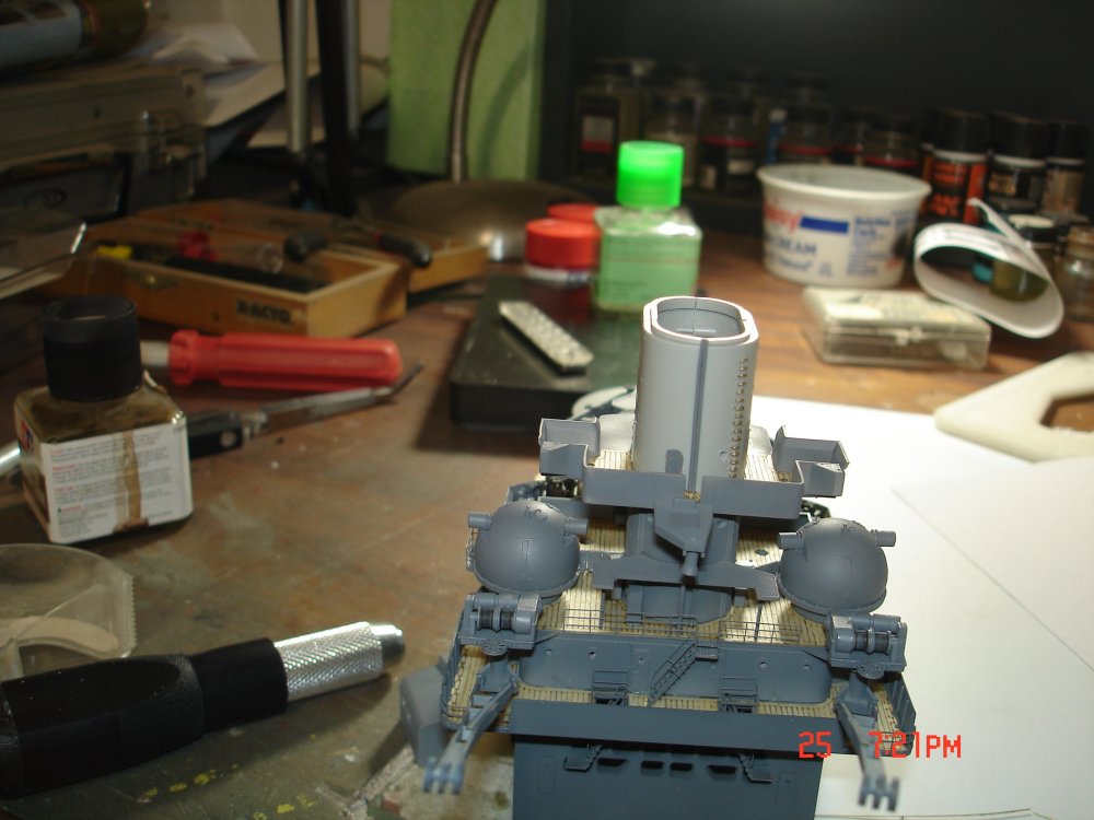

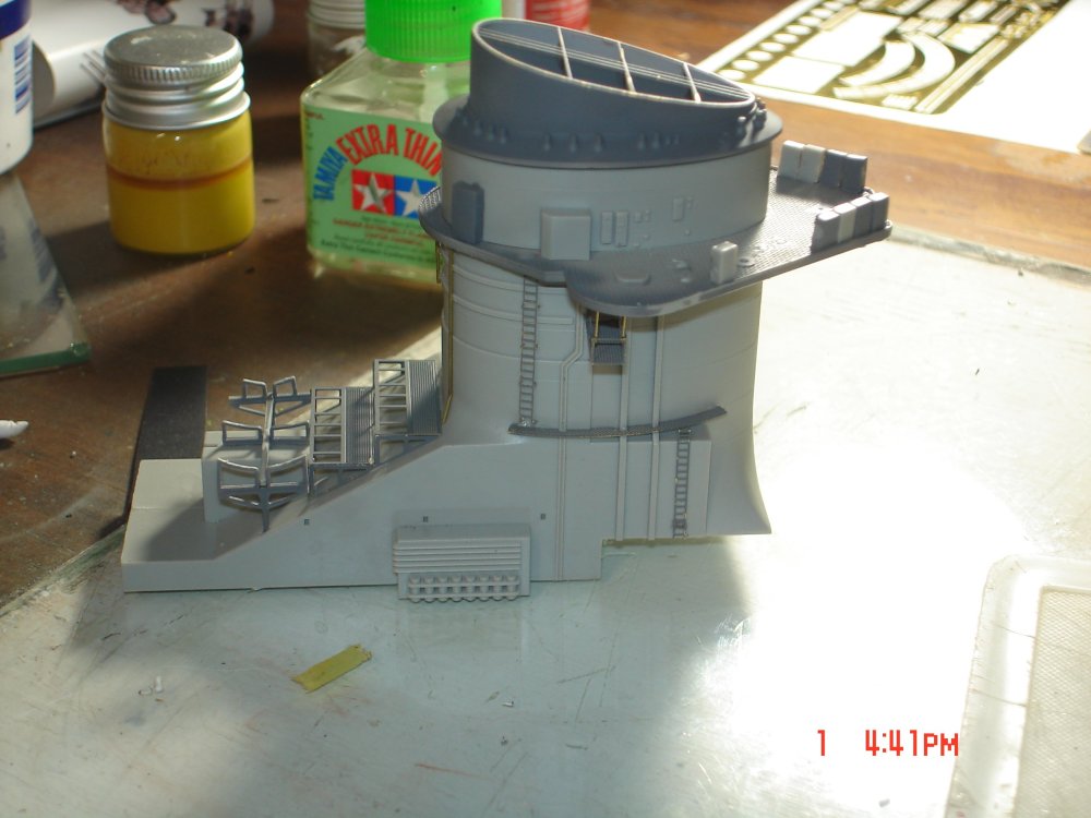

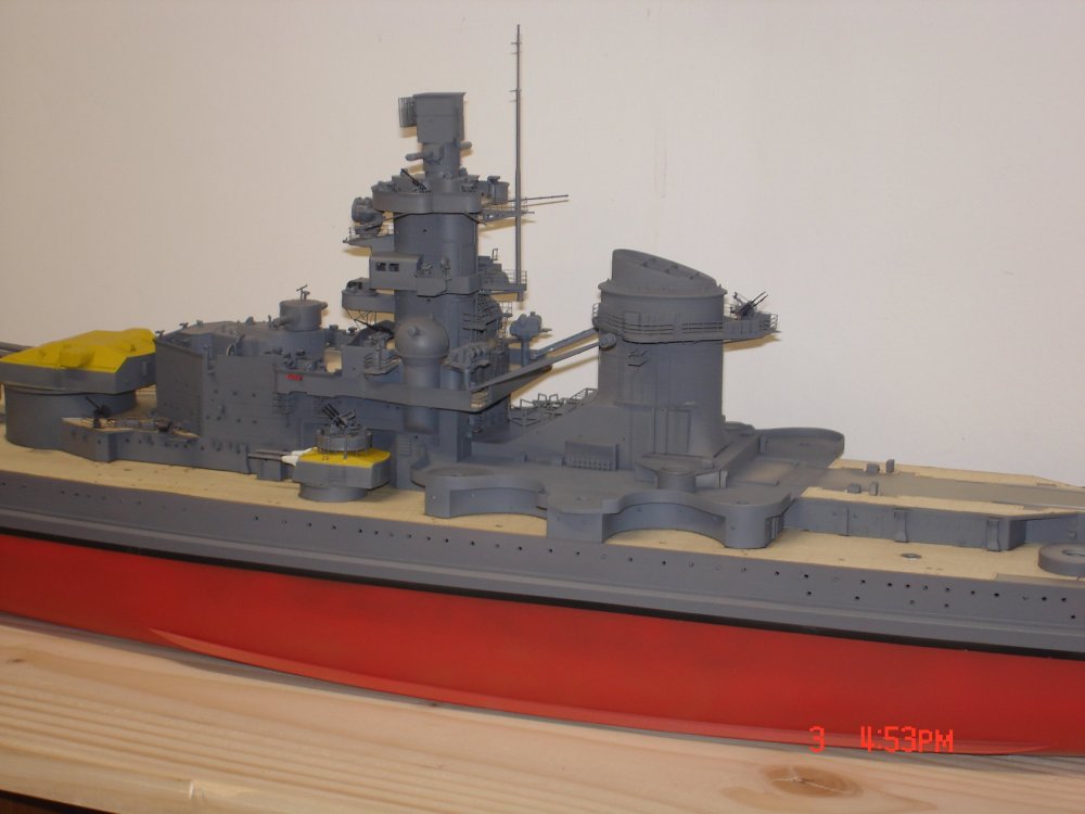

The funnel starts to come together you can see brass tubing being added and more ladders๐Ÿคจ
The 20MM actually have baskets with holes in them to catch spent shells Bunker Studios.Very Nice but fragile had to buy more than needed.

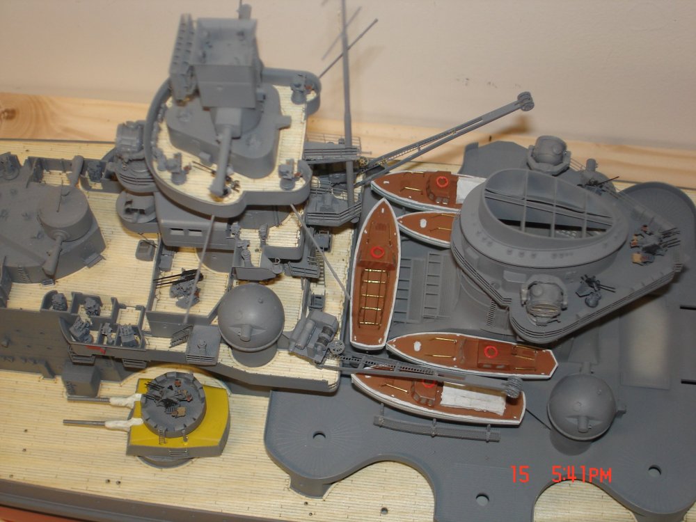

Things are being built as modular nothing even as of today SS,Funnel or rear SS are glued to the deck only when all the rigging is complete.

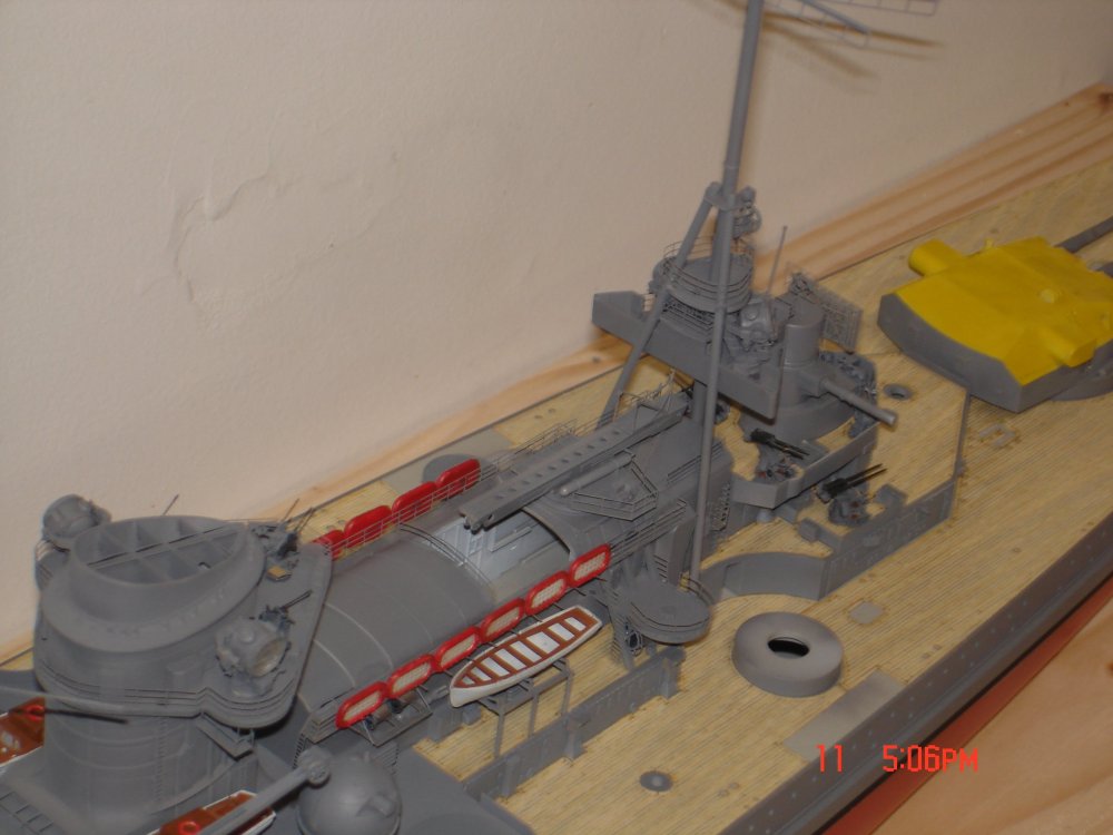

Last installment for tonight

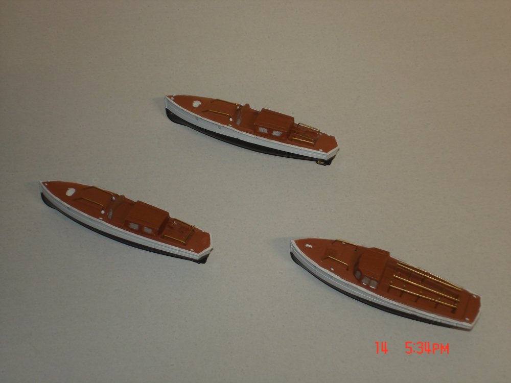

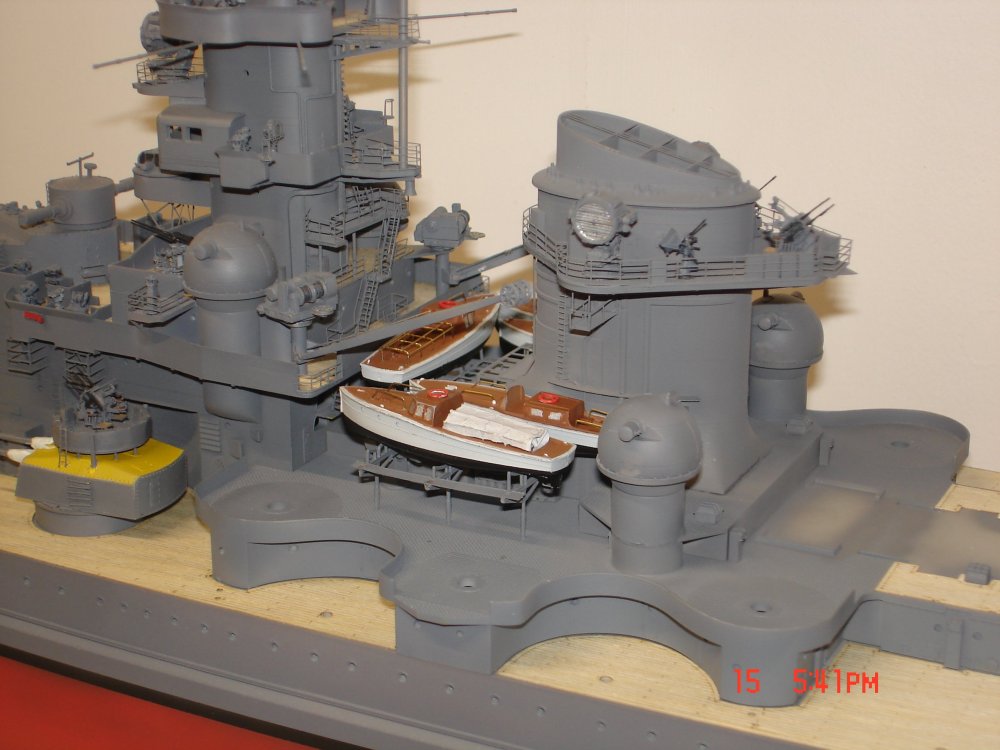

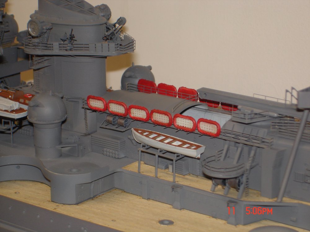

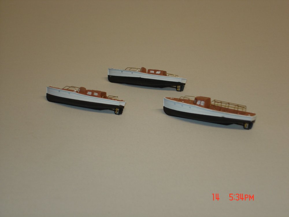

The boats .015" brass some canvas coverings happen later.
I think I later replaced that cover just a test.

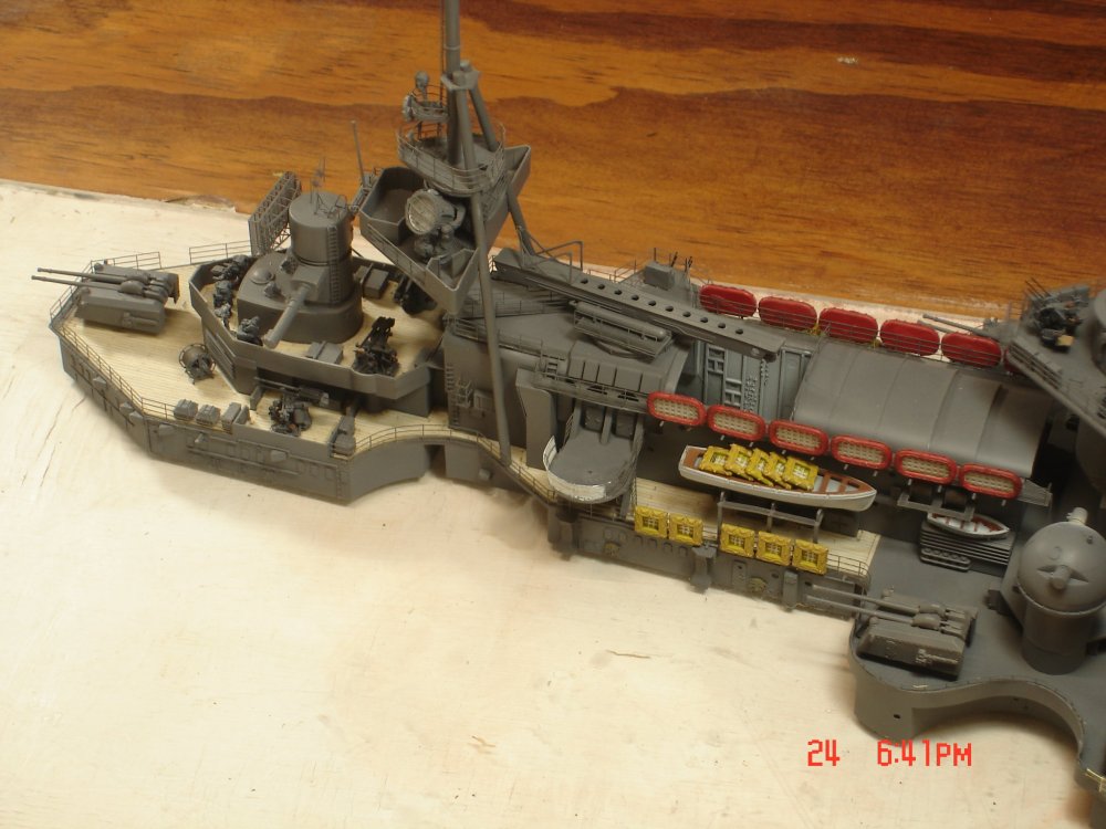

I searched high/low for these rafts to get the right scale Trumpters were way to big I ordered another company while advertising as 1/200 were closer to 1/350 you see the book gave you the dimensions and these fit the bill.

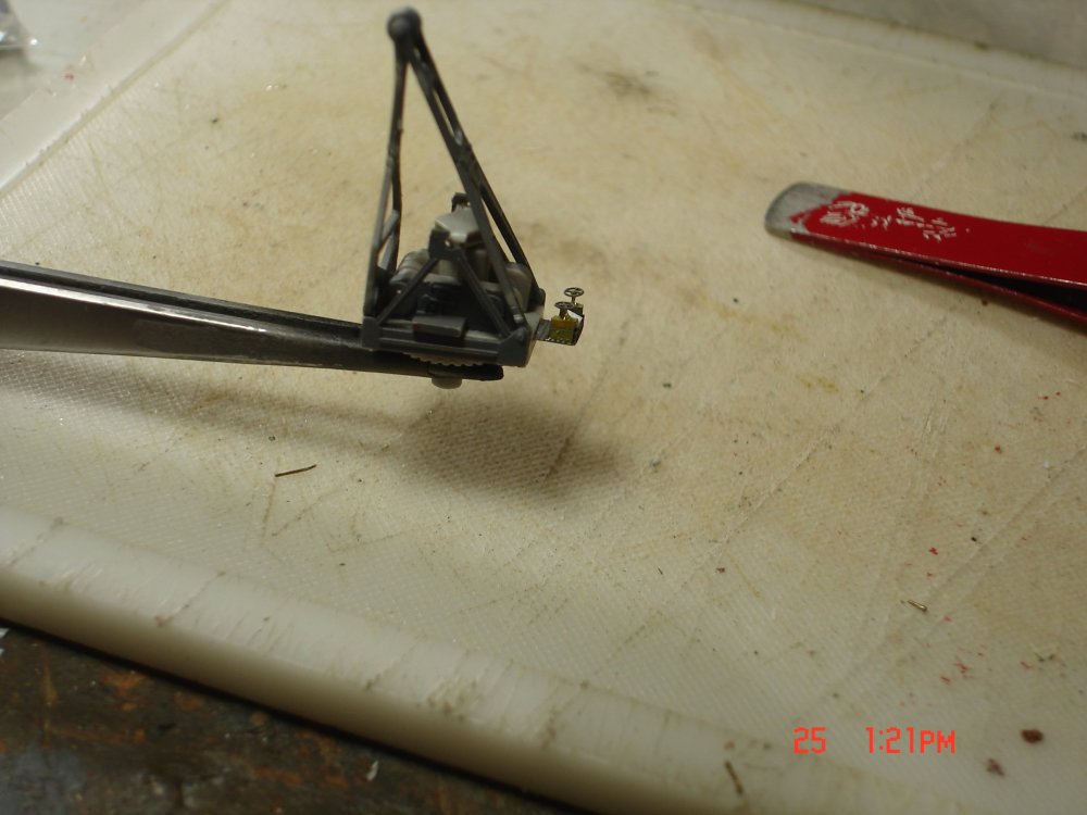

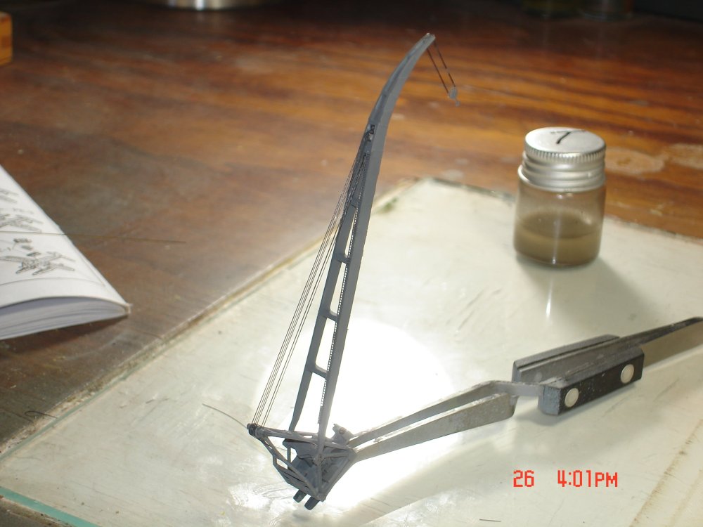

Time to update some more small renovations are happening in the model room ATTM and this one hits the desk when through so have to update.๐Ÿ˜‰

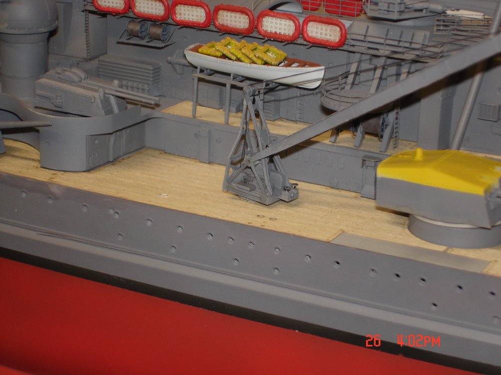

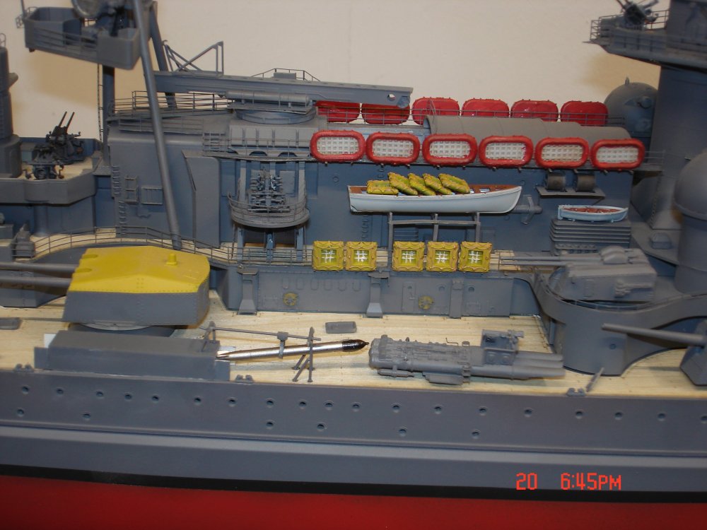

This the crane for the planes and torpedoes getting modified

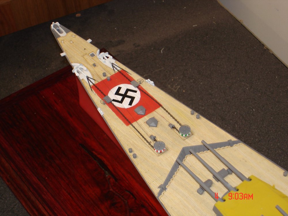

just a view at that point in time my second ship doing blast bags has started.Swastika up front gets a redo.

I added the small chains for securing the anchors and there anchor points

The reels and AA's from Bunker Studios.

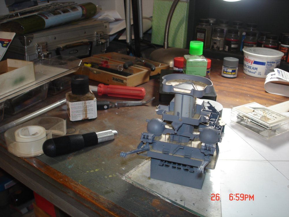

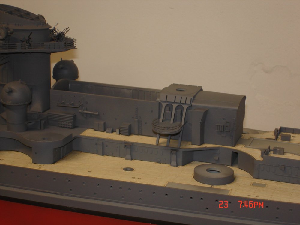

Starting to map deck accessories
opened the doors on the torpedo hold
Rear SS

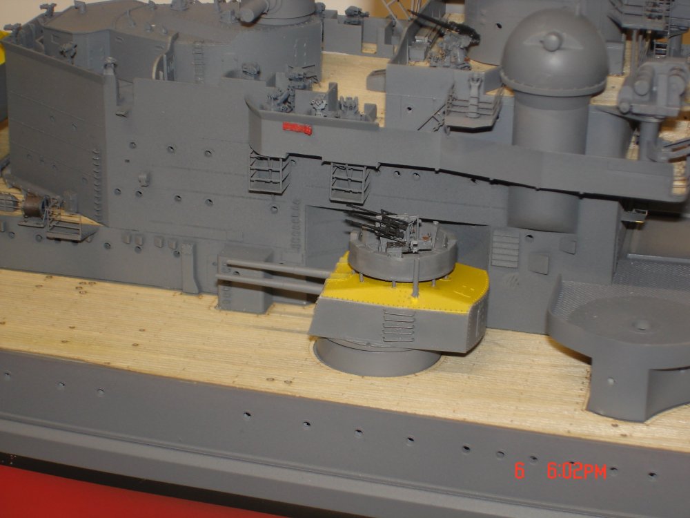

Why this pic? the fire reel (underneath/center) and box it sits on were not in the kit but there for Paderborn

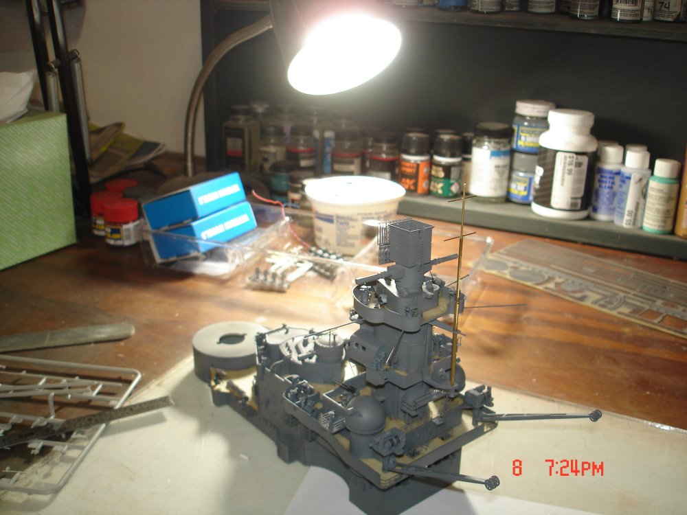

Rigging started and a different camera what's the thoughts?

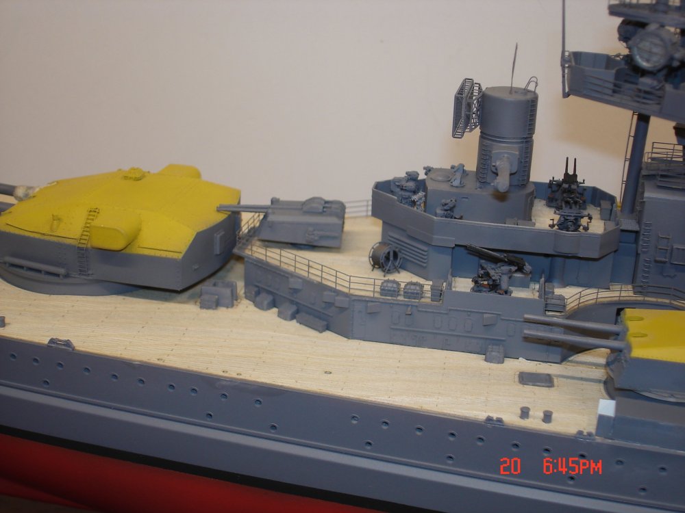

I had some small repairs to be made only vaguely remember an incident and poorly at that.The railing around a gun was damaged beyond use so took outside railing and converted it.The outside railing carried a pole every 6-8' feet inside was 1/2 of that.The railing around the Flakerling needed the canvas covering trying something Plasmo did on a 1/350 scale clear glue we use for transparency on aircraft one can see works well application is the issue right ATTM toothpick tonight kinda big rectangles. ๐Ÿ˜‰
Had to add the two uprights in the middle and touch the railing from the L to the center section railing.I truly do not think any Joe would ever notice but I wanted it as close as possible to the other side.๐Ÿ˜‰
Just paint with a white and a touch of light grey and wala.
Looks good from the inside.

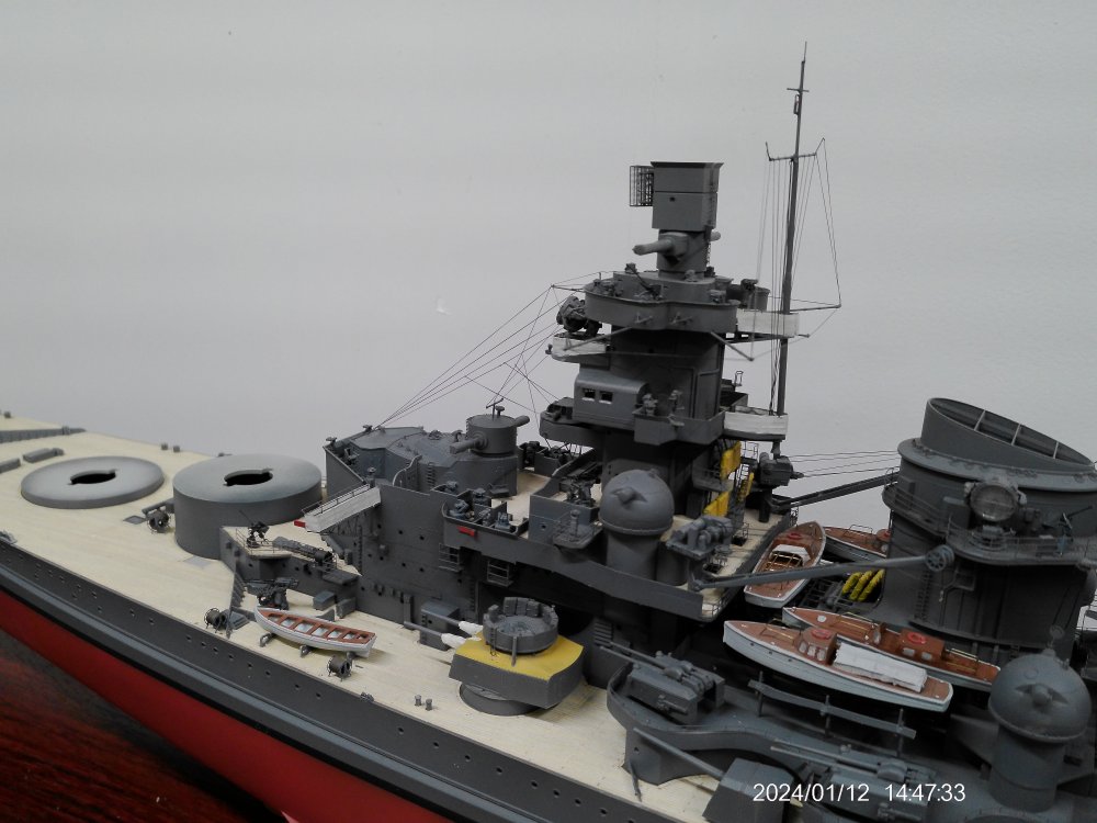

Well the rear SS is about to get glued to the deck.I had to make a couple parts for the rear mast I had noticed some time ago but forgotten.The top of the mast added in 43 is the FuMB Antenna3 Ball passive detector and below it is the White top light now to paint.
I made that light atleast 6X times it was pissing me off so small classic_blink

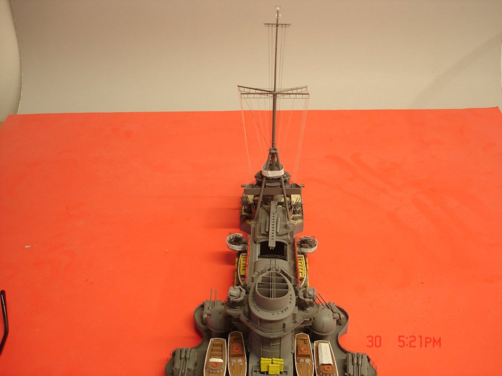

The boats are finally glued in place.I used the Waldron Punch to make the life rings on top.

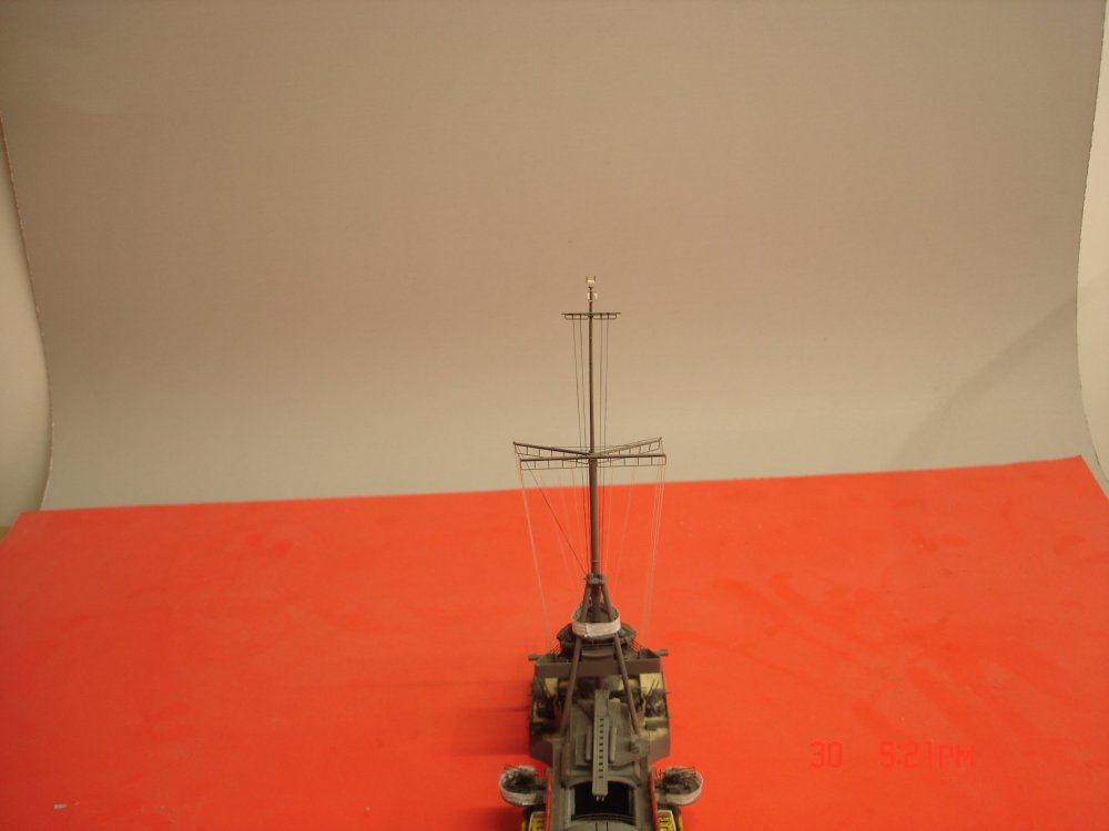

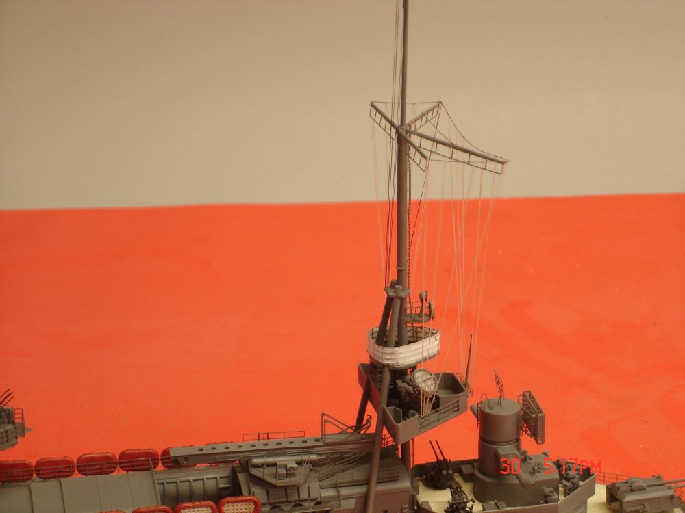

The rigging for the mast lots of rope lines I give myself a "D" here it was hard getting a semblance at the top of width.classic_dry
I used Plasmo's technique of a white glue mine be Tacky Glue slightly thinned down bigger holes needed a thicker glue.classic_wink
