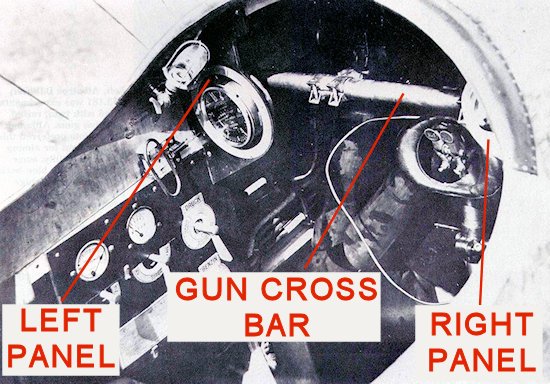

Some details of the cockpit needed modifying to better reflect a Series 253 series aircraft.
The pilot's instrument panel was not a single span panel, but two separate panels (left and right).

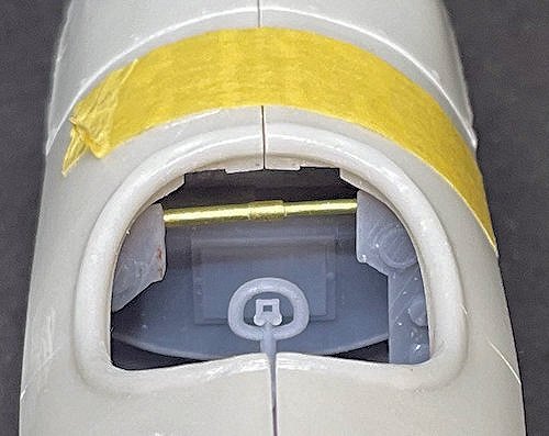

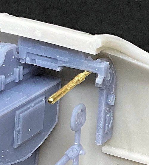

The rear of the two machine guns were mounted on a cockpit cross bar.

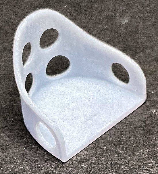

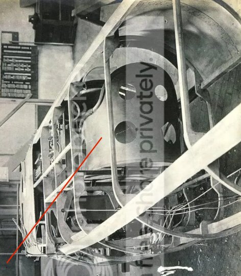

Also, the pilot's seat was not normally solid wood, but had several large lightening holes
Therefore, I've cut the instrument panel into two panels, added a Brass rod/tube cockpit cross bar for the machine guns.
Also added lightening holes in the pilot's seat.

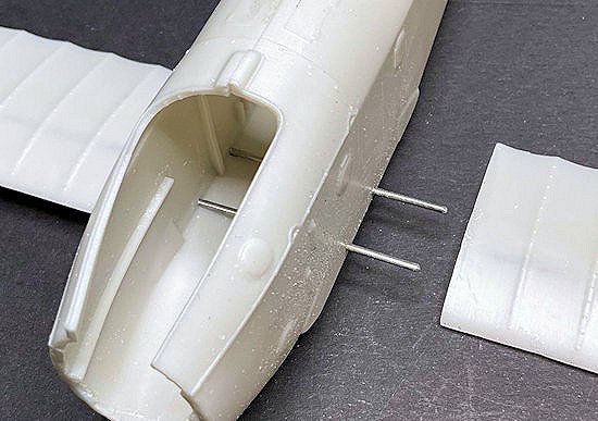

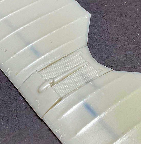

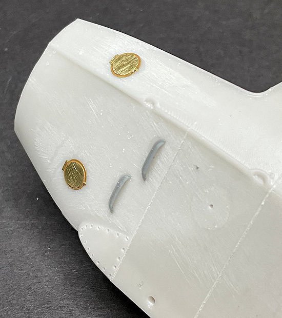

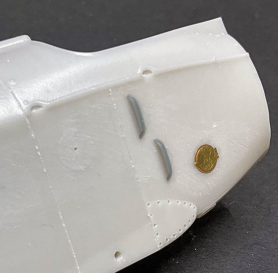

I've removed the cast hatch panels and cooling louvres from the fuselage.

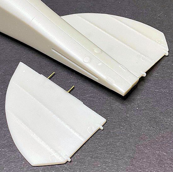

Kit photo-etch alternative panels fitted with 'Proper Plane' replacement cooling louvres.

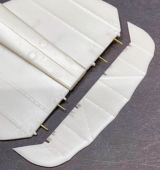

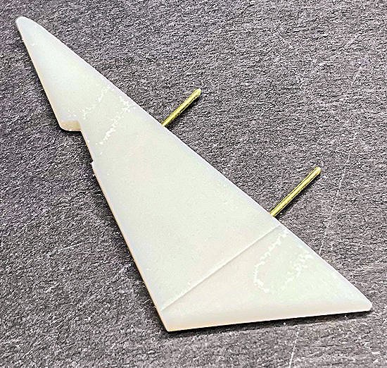

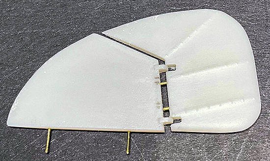

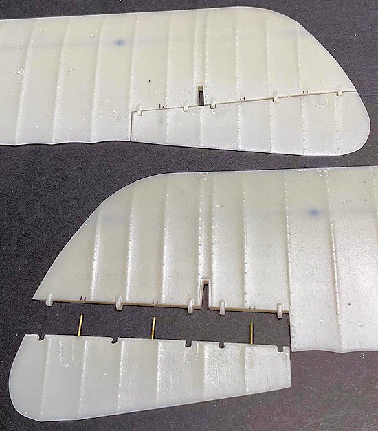

Support rods added to flight control surfaces etc,
