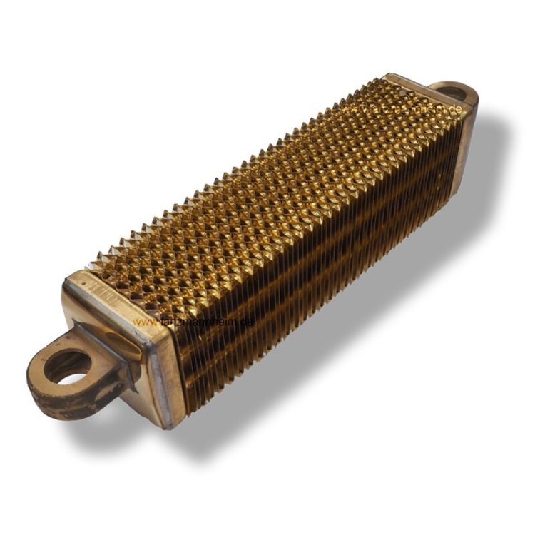

Thanks😀 Here's what one of the radiator sections looks like on the Bulldog.
lanz-bulldog-radiator-reiement-to-bulldog-no-130970-for-replacement-see-61290a-3275689678.jpg

Clearly looks brass, Paul. I would spray it with brass color or us the wax, if the texture allows, followed by a matted oil wash and some metal pigments for highlighting.
