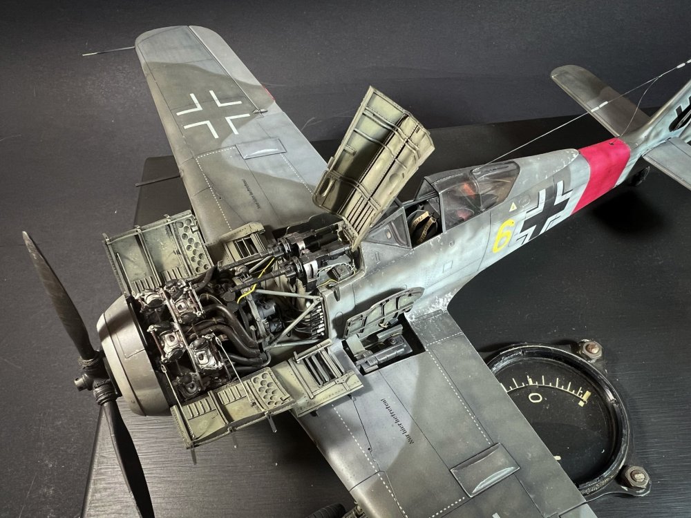

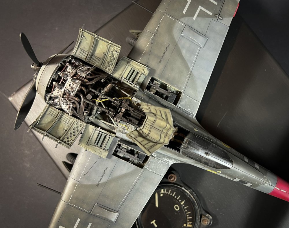

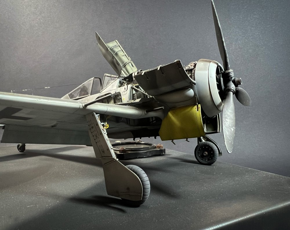

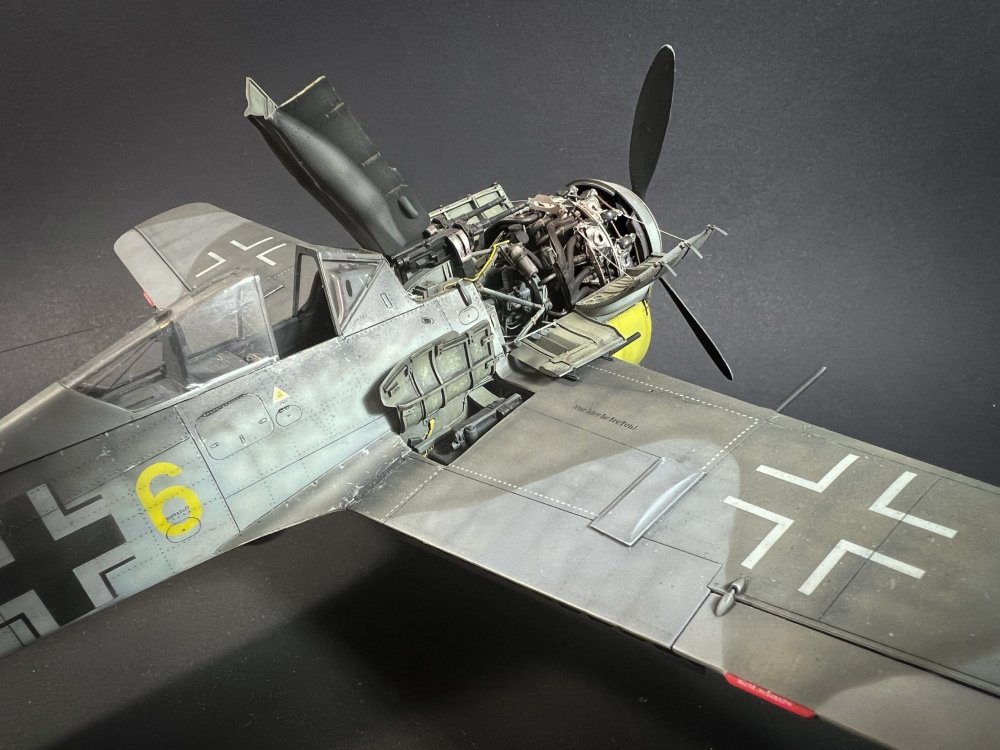

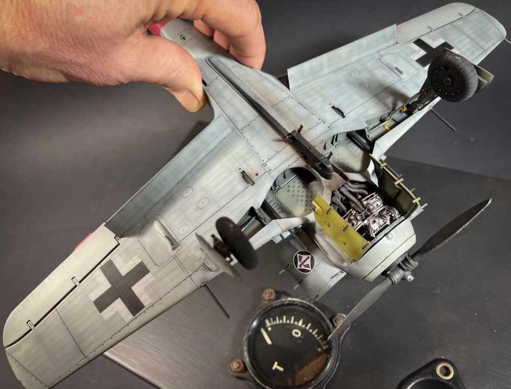

FW190A-8 Gelbe 6, Crashed at Vreeland (Holland) during operation Bodenplatte

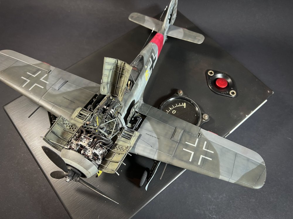

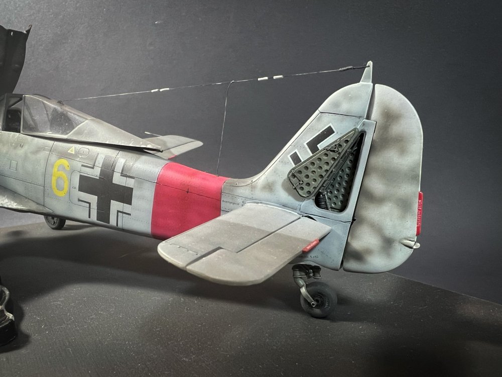

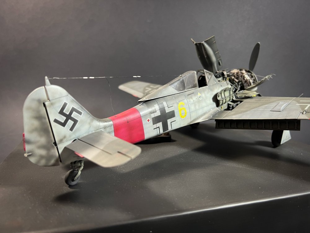

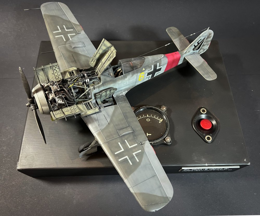

This is maybe my best model. Or: the one I'm most proud of.

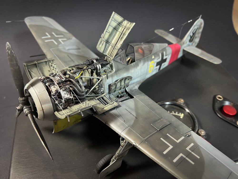

It started of as a Revell Fw190A, which I transformed to a A8 by 3D printing the cannon bulges and ejection chutes under the wing.

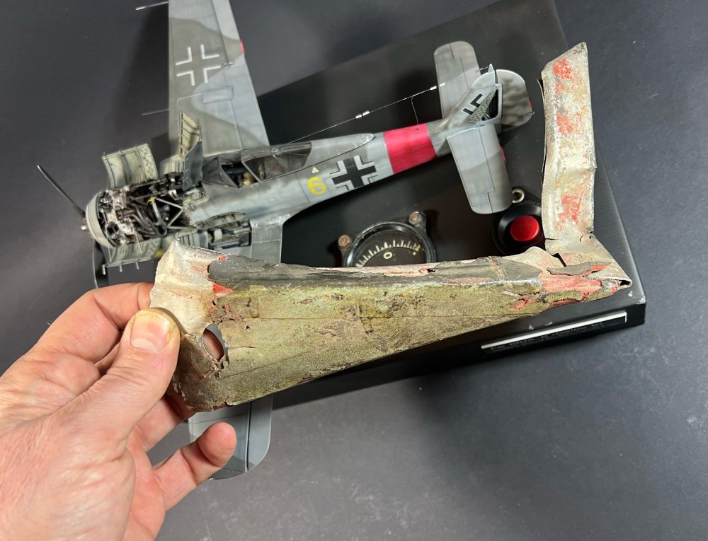

I was gifted a piece of aileron with the paint and some fabric still on, recovered around 1980 in Vreeland. Close to Schiphol Airport in The Netherlands during Operation Bodenplatte. Heinz-Jürgen Kilian of 3./JG1 was hit by friendly AA and managed to bail out. His chute did not open, or opened too late and he landed hard on a frozen stream and died.

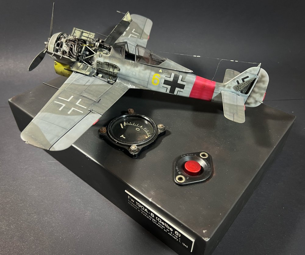

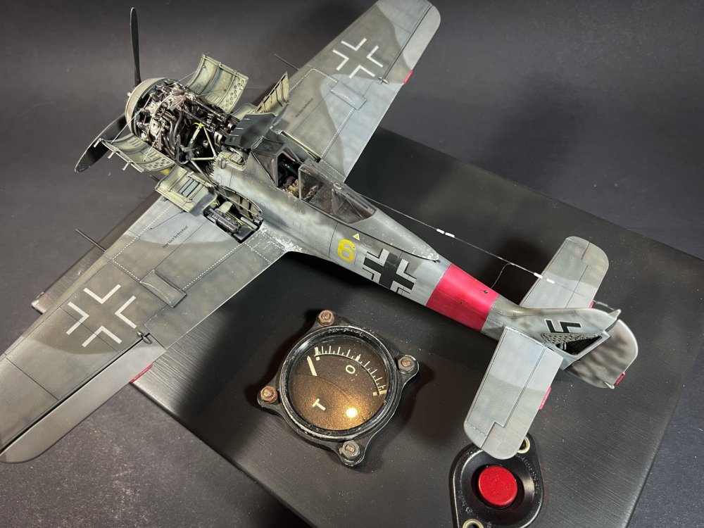

The base was made of laser but and bend aluminium sprayed RLM66.

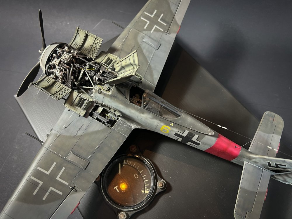

The trim gauge and fuse button are from a Fw190A and can both be found in the left console.
I used 1ManArmy masks, all the Eduard sets I could find, etc..
