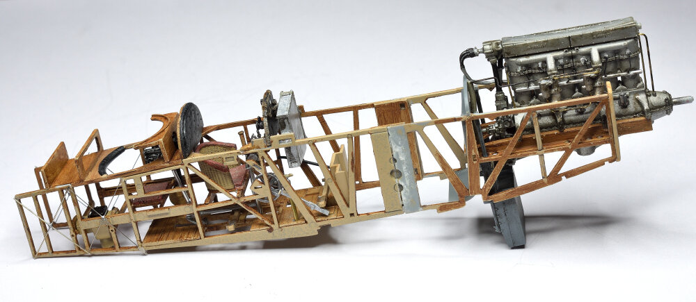

first job, experiment with oils for wood finish. I sprayed a good coat of deck tan then over brushed with a mix of oils
these oils take an age to dry so i will probably look at the engine next

No easy way to tackle these vintage control panels. They are very 3D so not a lot of good for 3D decals or PE, you just have to get your smallest paint brush out and hope no one looks to close
The instrument panel looks good. You’ve also achieved a great wood grain through painting.

Lots more of the wood painted now,and it needs a week to dry as its oils so playing engines at the moment 😀

i just hope this lot fits inside the Fuselage halves.
The moment of truth with WNW kits, I wish you luck. Interior looks great, even from the outside classic_wink.
  • Author
Buttoned up and looking OK ..............thats a relief :-)
