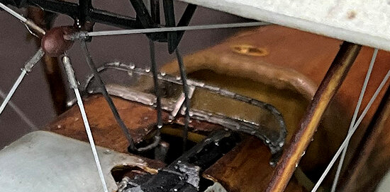

So, the cockpit has been completed and fitted into the fuselage/lower wing.
The only modifications so far was the addition of fuselage internal bracing wires.
Also flight control cables and replacement pilots wicker seat.
Mike

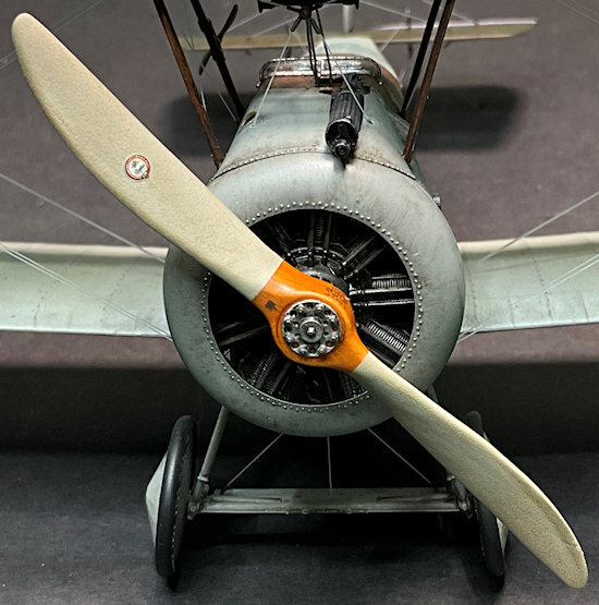

Hi all,
Although the kit supplied propellers are of good qualify, I chose to use a replacement.
Proper Plane’ wood laminated (WP005) propeller.
Tamiya clear orange was lightly airbrushed over the propeller to give a varnished effect.
The blades were airbrushed with Tamiya Royal Light Grey (XF80).
Final clear coat of semi-matte was airbrushed to seal and protect the paint and decals.
Tamiya Weathering Master Set A (Mud) was lightly sponged across the blades to give a worn effect,
Mike

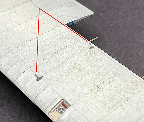

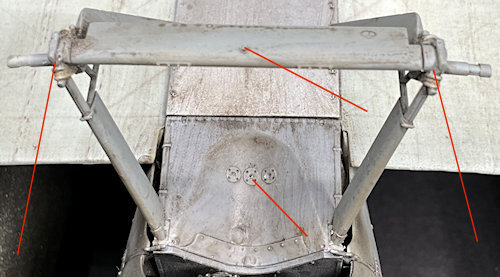

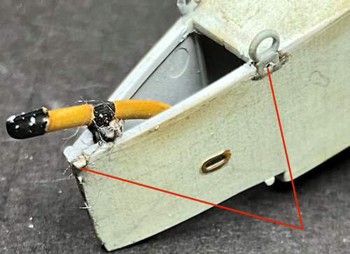

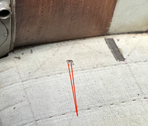

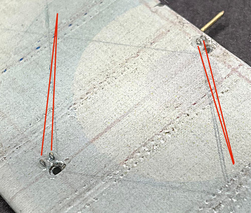

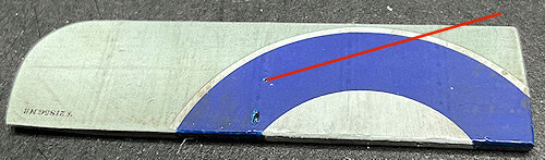

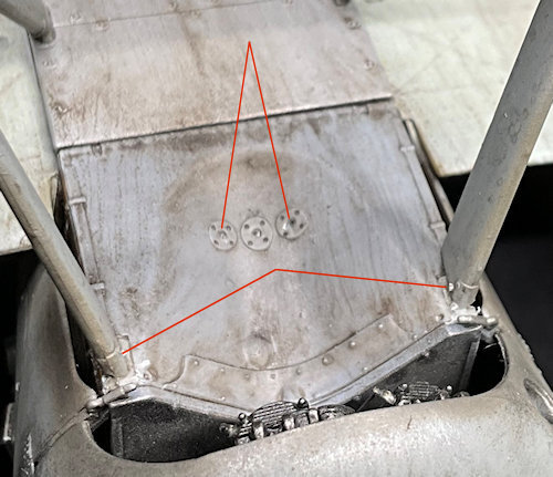

  • Author
Hi all,
In preparation for pre-rigging, I needed to drill rigging holes.
Also to add rigging anchors before assembly continues.
The drilled holes are either 0.2, 0.3 or 04 mm diameter dependent on they're use.
The rigging anchors fitted are the photo-etch HGW 1/32nd scale Spoke Eyelets (132129).
I've taken to using these as I wasn't prepared to keep getting GasPatch metal anchor points.
Those keep turning up with 90% of the parts blocked with metal.
I'd rather not use resin parts either as they can break under strain.
The HGW eyelets are strong enough and can be easily threaded with rigging materials.
Next up is to pre-rig what is necessary before assembly continues,
Mike

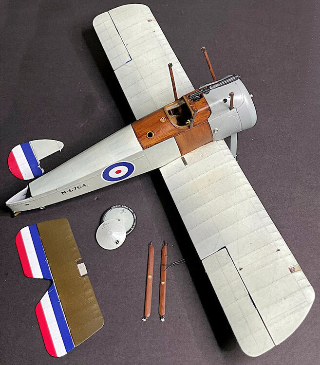

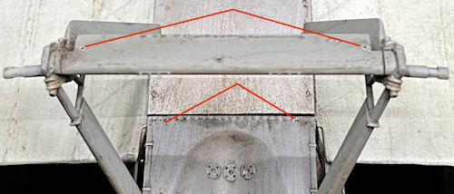

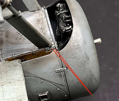

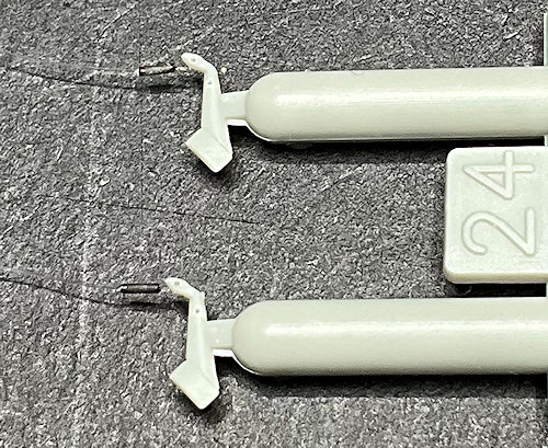

  • Author
Hi all,
The necessary pre-rigging is done for this stage of the build.
Materials used are:
0.08 and 0.12 mm diameter mono-filament.
0.4 and 0.5 mm diameter blackened Brass tube.
The fin/rudder, ailerons and tailplane will be fitted and rigged once the upper wing is on and rigged,
Mike

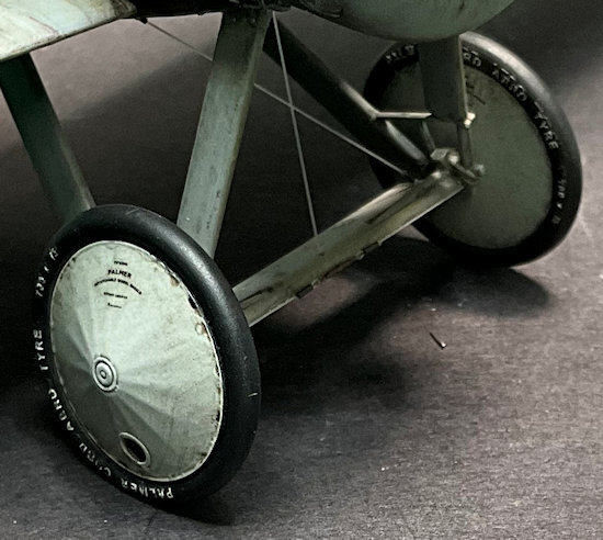

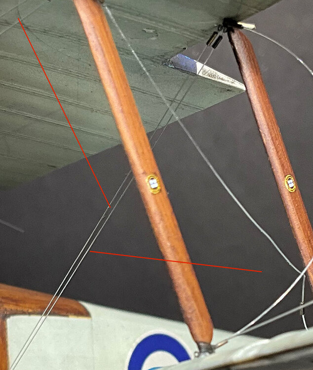

  • Author
Hi all,
The fragility of the Camels cabane and interplane struts is well known.
Therefore, before fitting the upper wing. I final rigged most of the landing gear bracing wires.
The colour of the second photograph is due to the ambient lighting.
There is one more horizontal wire to be added, which will be part of the forward flying wire, when rigged,
Mike

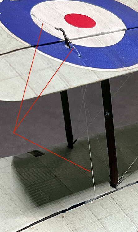

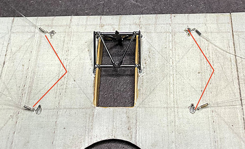

  • Author
Hi all,

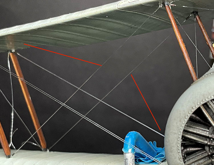

Wing rigging is done.
The photographs are in the order that the rigging was applied to the model.
Cabane strut bracing wires.
Flying wires.
Landing wires.
Incidence wires.
All 0.12 mm diameter mono-filament with 0.4 or 0.5 mm diameter tube.
The four ailerons are now fitted and rigging the aileron control lines is next,
Mike

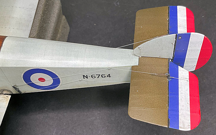

  • Author
Hi all,
The aileron, elevator, rudder and tail skid control cables have been rigged.
Just the fin bracing wires to add now,
Mike

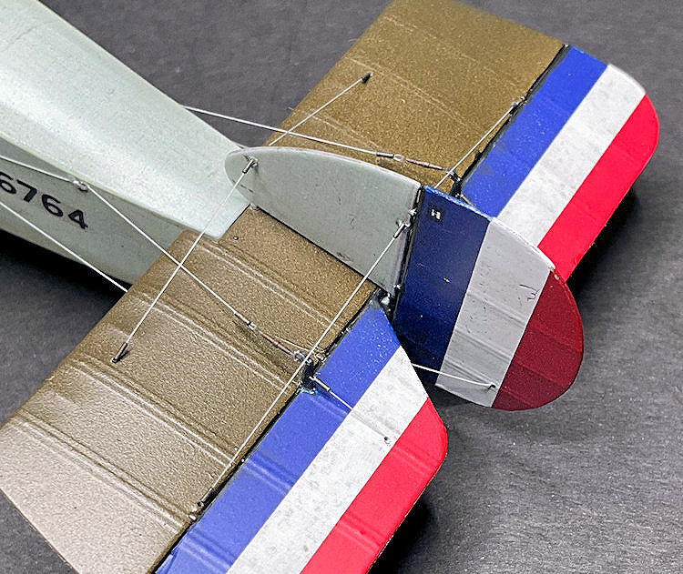

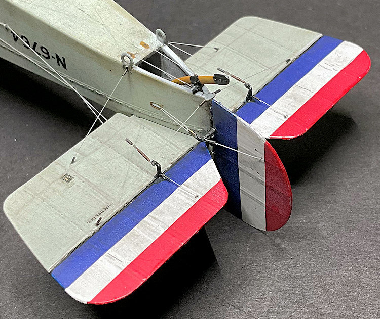

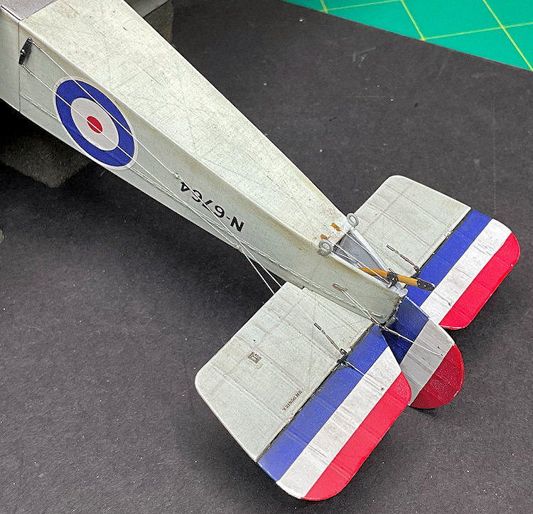

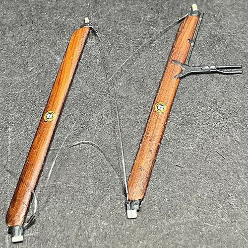

  • Author
Hi all,
The final bit of rigging is completed.
The fin/tailplane bracing wires.
Again 0.08 mm diameter mono-filament with 0.4 and 0.5 mm diameter tubes.

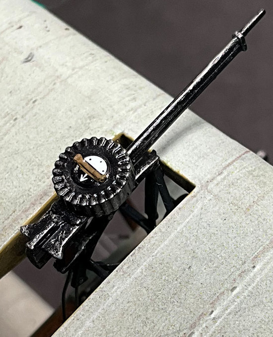

Now its onto the last few bits to fit:
Lewis machine gun and operating cables.
'Rotherham' pump propeller.
Windscreen.
Propeller.
Wheels.
Fuselage joint fasteners.
Mike

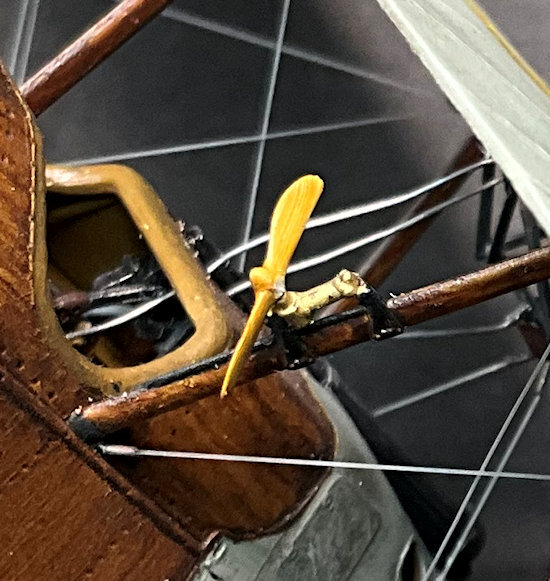

  • Author
Hi all,
Last few bits added.
Just the aileron control inspection windows to add now,
Mike
Edited by sandbaggeruk
Mike do you find using the mono-filament gives extra stability to the model? My problem with using the rigid stuff over elastic material is when you get one line tightened another may go slack. With my club hands I usually ended up burning a line trying to heat it up to make it tight again.
I´m not Mike, but the mono-filament adds definitely to the strength of the model. I built the huge AEG G.IV and it made the wings very rigid. I loop the thread through an aluminum tube, then through the eylet, which I CAed into the wing or fuselage and again through the burr free aluminum tube. Then I tauten the thread with a pair of tweezers and if you choose the correct diameter of tube and mono filament, it is self securing. Get that done with all the other rigging lines, check for slackening lines and if there are none, add a tiny drop of CA to the aluminum tube for securing the thread, job done.
Hi Moon Puppy,
Rob (Doc) gave good advice in that it definatly adds structural strength to the wings, landing and tail unit.
Also it never frays, snaps or distorts.
Admittedly, tightening slack lines using heat can be tricky and a steady hand is necessary.
Personally I tend to rig each set of lines (cabane struts, then flying wires then landing wires etc) and heat tighten them as I go.
I use a fairly small electric soldering iron to shrink slack lines.
I've built over 60 1:32nd scale model to date and all are rigged with mono-filament
Unlike photo-etch, stretched sprue or elastic lines, none have altered from finishing the build.
Mike

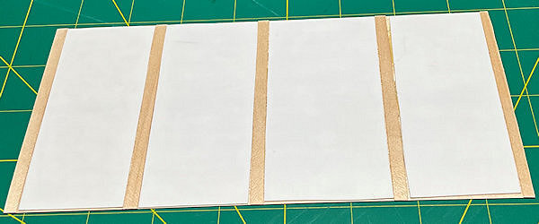

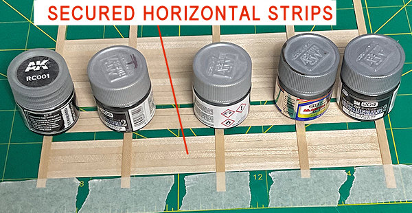

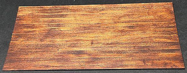

Hi all,
Instead of the usual grass mats as a base, I thought I'd make a basic representation of the launch platform.
The wood platform is made from Hobbies Ltd white Maple planking bundle (WMP055).
These are 6mm wide, 1 metre long and 0.5 mm thick (bundle of 5).
Horizontal strips were cut and secured together with PVA adhesive applied to vertical strips on the underside.
Plastic card rectangles of 0.5 mm thickness were secured between the vertical strips to prevent any flexing.
Finally, Windsor & Newton Griffin Alkyd oil paint (Burnt Sienna) was hard brushed along the upper surface of the strips,
Mike
