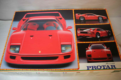

Neat to hear about the early history of Protar. I think Italeri continued to use the label up until at least the late '80s as my LHS has a Protar Ferrari F40 for sale.
Wheels & Wings Hobbies
No image preview
PRR199 - Protar - 1/12 Ferrari F40 Turbo - WWHP111029
Preowned Protar 1/12 Ferrari F40 Turbo kit (PRR199). Resealed, mint. Iconic twin-turbo V8 supercar in impressive large scale with detailed engine and interior.
Those definitely weren't around in the '60s or Ford would never have won Le Mans. 😆
