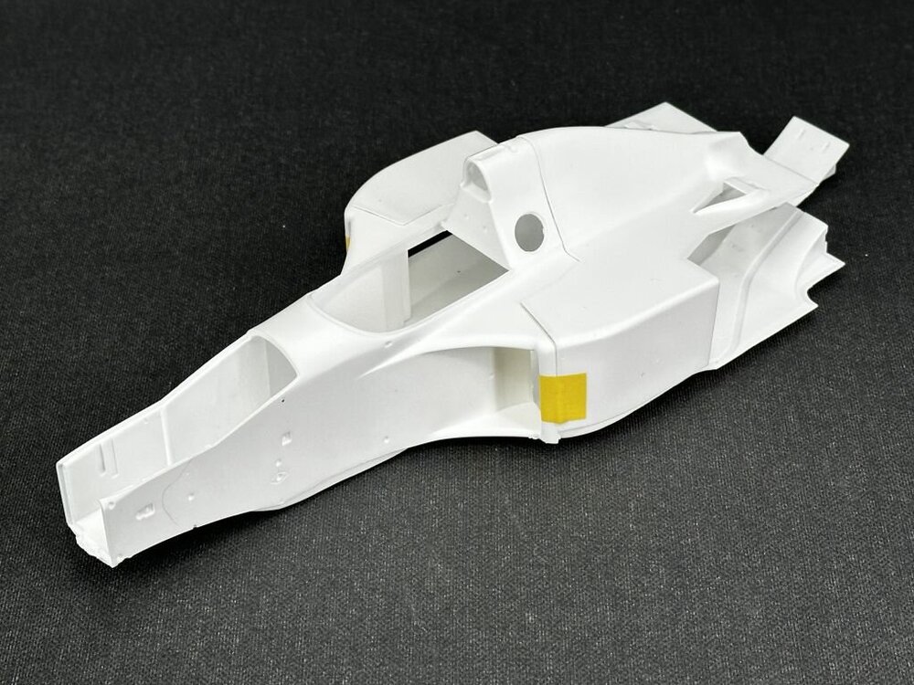

The body and many other parts are made from white resin. The cast quality is near perfect, without any bubbles or blemishes, only a tiny bit of flash here and there. The main components also seem to fit very good.

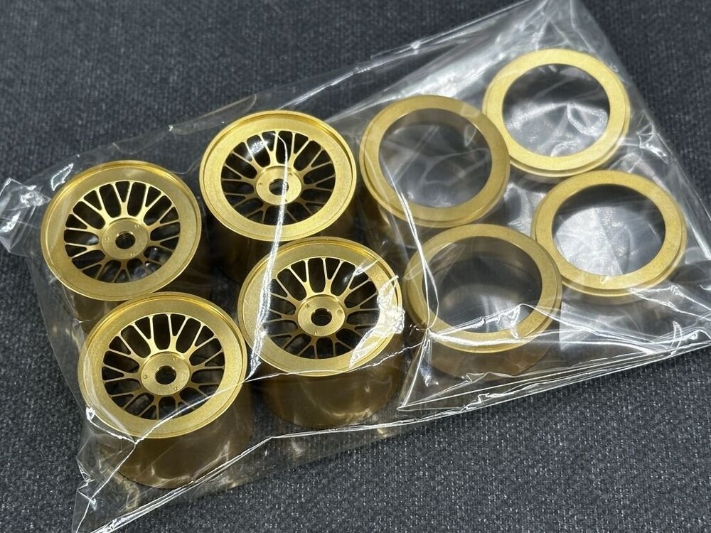

Another highlight are the rims with MFH kits in general, often turned aluminium with an insert from cast metal, but here you got the holy grail rims of all in readily gold anodized aluminum.

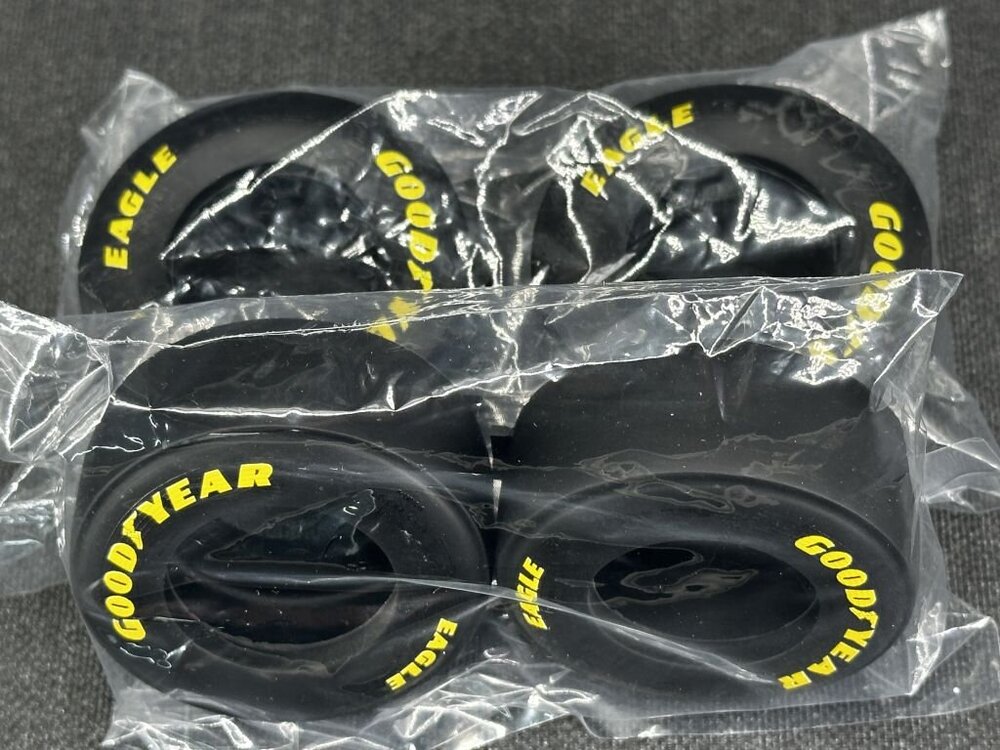

The rubber tires are pre printed with the makers branding, very nice.

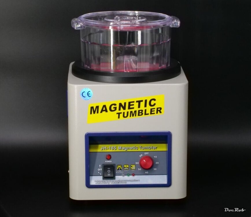

After checking, I usually clean the parts in a magnetic tumbler filled with water and 0,3 mm needles. I skipped this step here, because there are no unpainted or polished parts in the kit and you always loose a tiny bit of detail sharpness with cleaning.

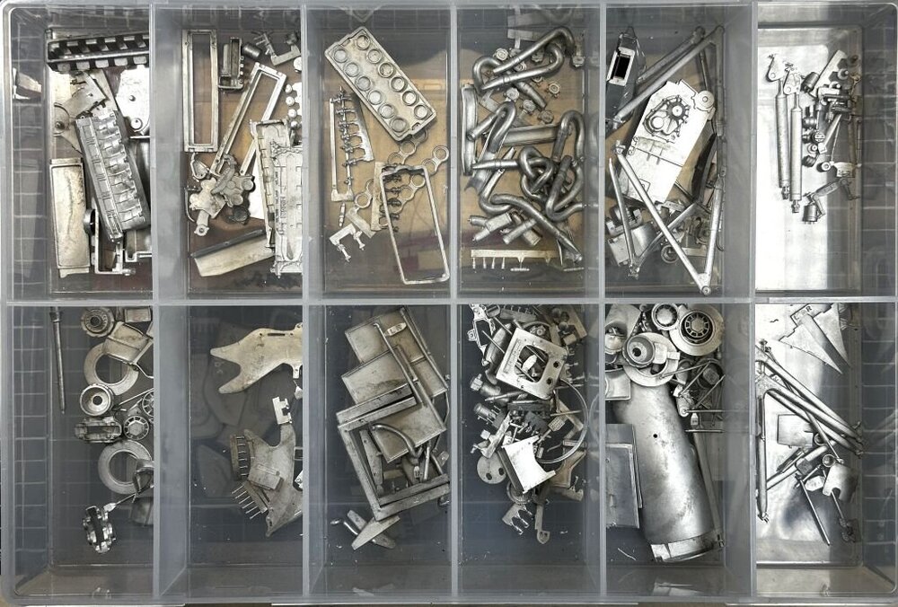

Next is a very eye tearing job to do, sorting the parts according to the steps of the manual, best into sorting boxes. It is exhausting, but you get a good feeling for the parts and where everything belongs.
Here are the (mainly white metal) parts sorted.

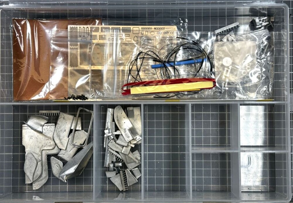

The last box also contains also a lot of the supplied goodies, like PE, some clear resin parts, turned aluminum funnels and axles. different types of aluminum rivets, a suede leather sheet for the seat cover, fabric and metal parts for the seat belts, ...

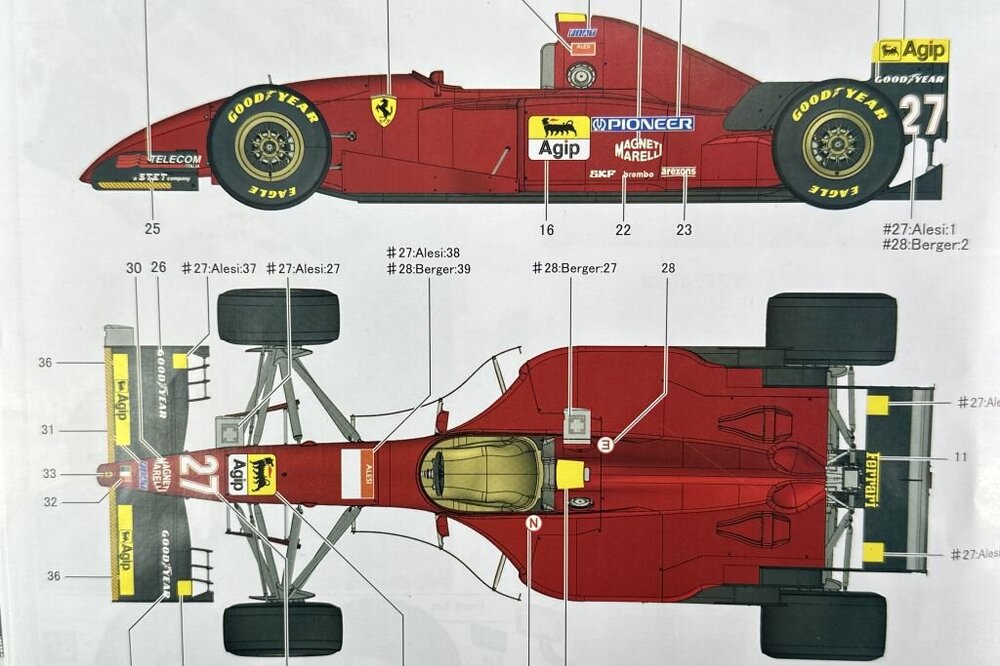

Not shown are the decals, in this case printed by Cartograph. There are thre sheets, one with the decor, including tobacco sponsors and two with carbon fiber decals.

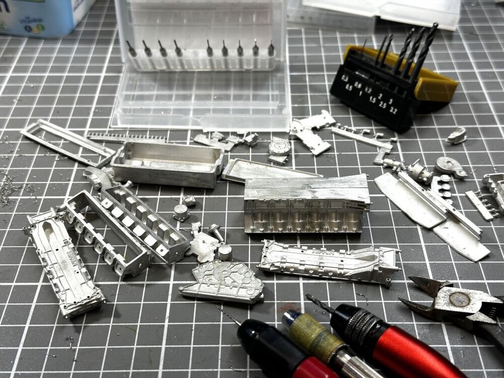

- Have lots of good drill bits at hand. The PCB drill bits "eat" into the metal wasily, the classic HSS drill bits are better. I prefer mostly hand drilling, as it is so easy to drill too deep, using a power tool.
- You should have a caliper

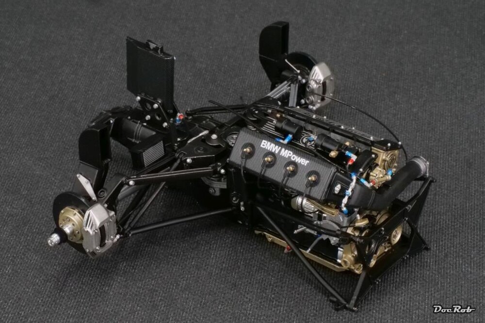

Hi Rob, I am having with part m192 interfering with the intake I’ve arrowed.

I suspect it’s m192 at fault as it was quite misshapen and I thought i had straightened it. As it is if fouls the end of the intake so something is obviously wrong.
I should have built all this up beforehand but it’s my first MFH build and I’m still learning the ways… I think my plan will be to build up the intercooler that the intake connects to and test fit that along with the lower bodywork piece and hopefully that will tell me if the problem is with the bracket or the intake?

Hi Nick, I guess you mean part M1, the front frame, right. I also had a lot of difficulties to fit part one onto the engine block and connect them with the V-shaped parts (M204, M205) at the same time.
If I remember correct, I cut away the lower connection points from part M1 to the engine block, to geet it right. I glued part M1 flush to the engine and managed somehow to connect all other parts.
Are you sure, that part M1 sits perfectly correct with yours, it´s absolutely critical, but hard to see. You should check this and of course the fit of the airbox RE14. Part M1 later connects the engine and rear part with the front monocoque, so you should check this direction as well. There is no way, that the distance between engine and monocoque could be wrong.
Acetone does loosen CA glue, unfortunately the paint as well, but if there is no way around, it´s better to rebuild that part to get it right.

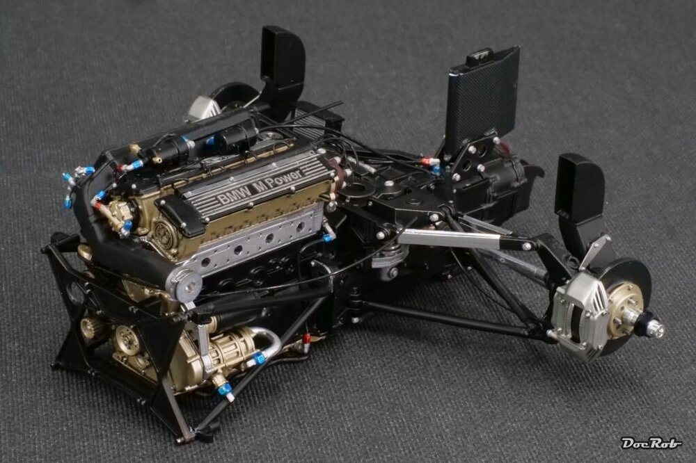

Here are two pictures, which show, hoe mine looked there:

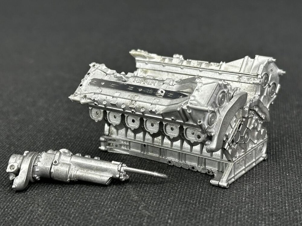

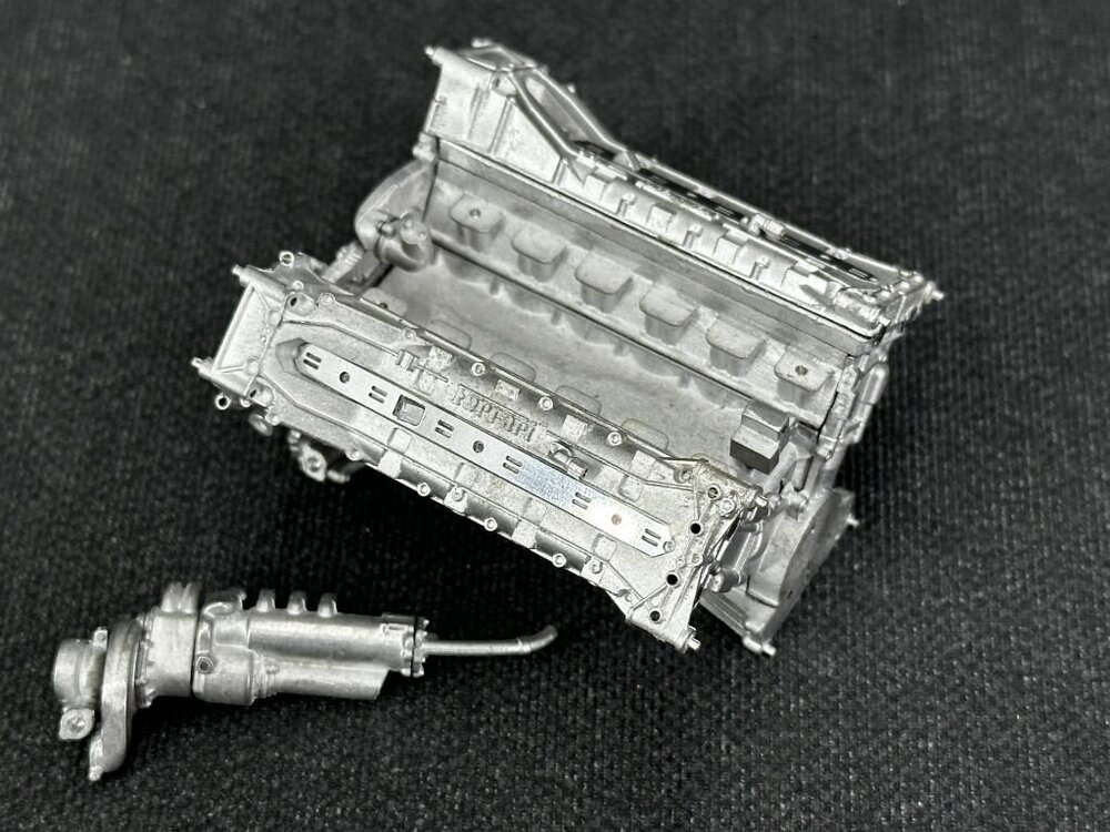

First real construction steps. I build up the main part of the engine in it´s full 12 cylinder galore. The 412 T2 power house consists from white metal and some etch parts only. Most MFH engines have a engine housing made from resin, which somtimes leads to a little bit more of adjusting work, because of minimal differences in shrinkage. I prefer it all metal and it is quite heavy.
There are some more parts to add, which I also build up, but add after airbrushing the engine. It is almost exclusively black, other than all my built MFH engines. The fit was very good and detail is very sharp and I hope, I can show that detail with my special painting technique.
I used some transparent Tamiya metal primer as a base layer then.

incidentally do you use a vibratory polisher of a wet tumbler ? I have 5 LB wet tumbler works with small ceramic chips

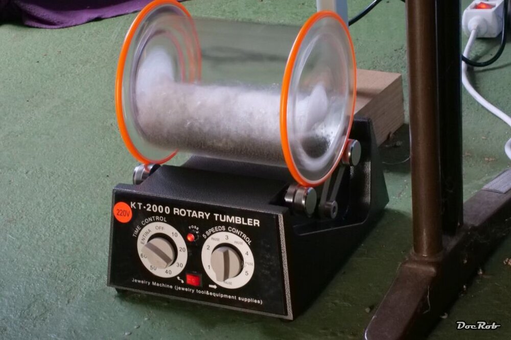

I cleaned all my past MFH kit metal parts with a magnetic tumbler. I use 0,3 mm steel needles for the cleaning together with soapy water. I tumble the parts for 30-60 minutes, rinse them under clear water and let them dry. The needle treatment leads to only minimal loss of detail and enhances the shinyness of the white metal. I also have the feeling thea due to the needle hammering, the surfaces are a bit harder.
For the Ferrari, I didn´t clean the white metal parts at all, as they looked good and there are no unpainted or polished parts.
Initially, I tried another tumbler for my first MFH build, the Crocker. It uses metal balls for cleaning. The shinyness is fantastic, but complicated shapes are only treated on the surfaces not the crevices or around protruding parts, which lead me to buy the magnetic tumbler.

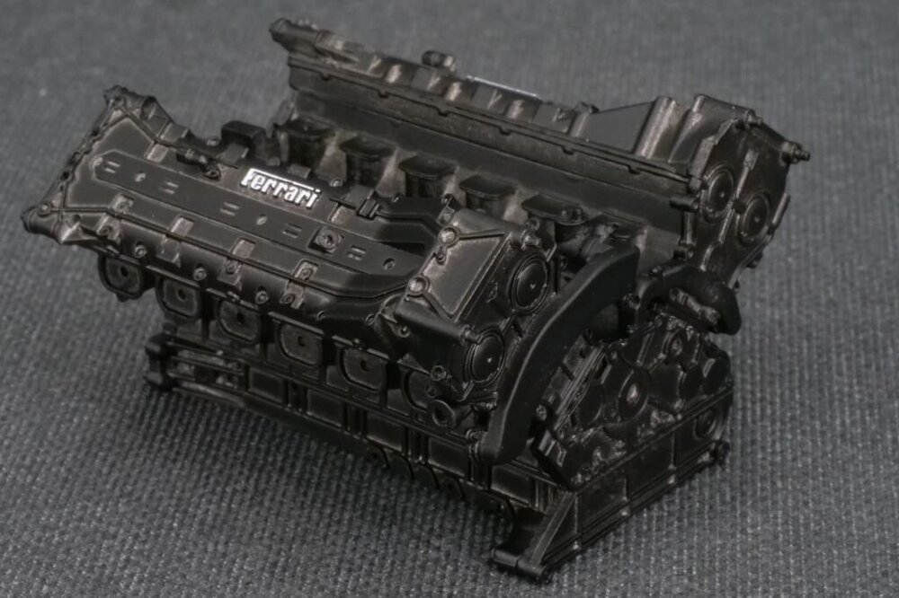

The engine and all other surrounding subassemblies got airbrushed in my signature spray variant. Therefore, I use Tamiya LP-5 semi matte black highly dilluted with leveling thinner and spray carefully over the parts, to hinder the very thin paint to run. The idea is to let the metal shine through for a tiny bit. It´s an effect, similar to drybrushing, but more regular and gives the painted parts a more realistic metal look. In reality, you mostly can visualize materials from their looks. You can see, what is plastic, metal or wood only by the shininess, reflections, color depth and surface characteristics. With a scale replica, you have to use airbrushing or painting techniques to simulate this. The effect might look a bit crude on the picture, but this will change while adding the subassemblies and wiring.
The Ferrari lettering was painted, using a white ball roller pen, which I used for the first time and I like the result. It dries matte and will also be helpful to paint brand logos on tyres.
