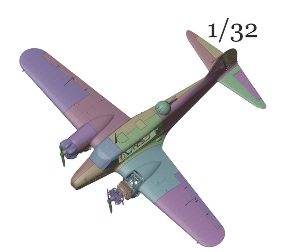

Just purchased the Aladdin Models 1/32 Avro Anson. A lot has been said on Facebook and LSP about the accuracy. I won't dwell on that too much, since this topic deals with the technical side of getting a proper and buildable print.

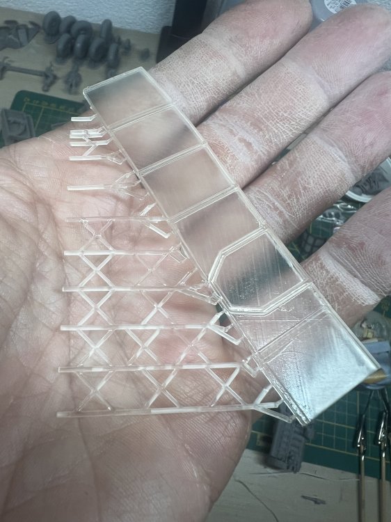

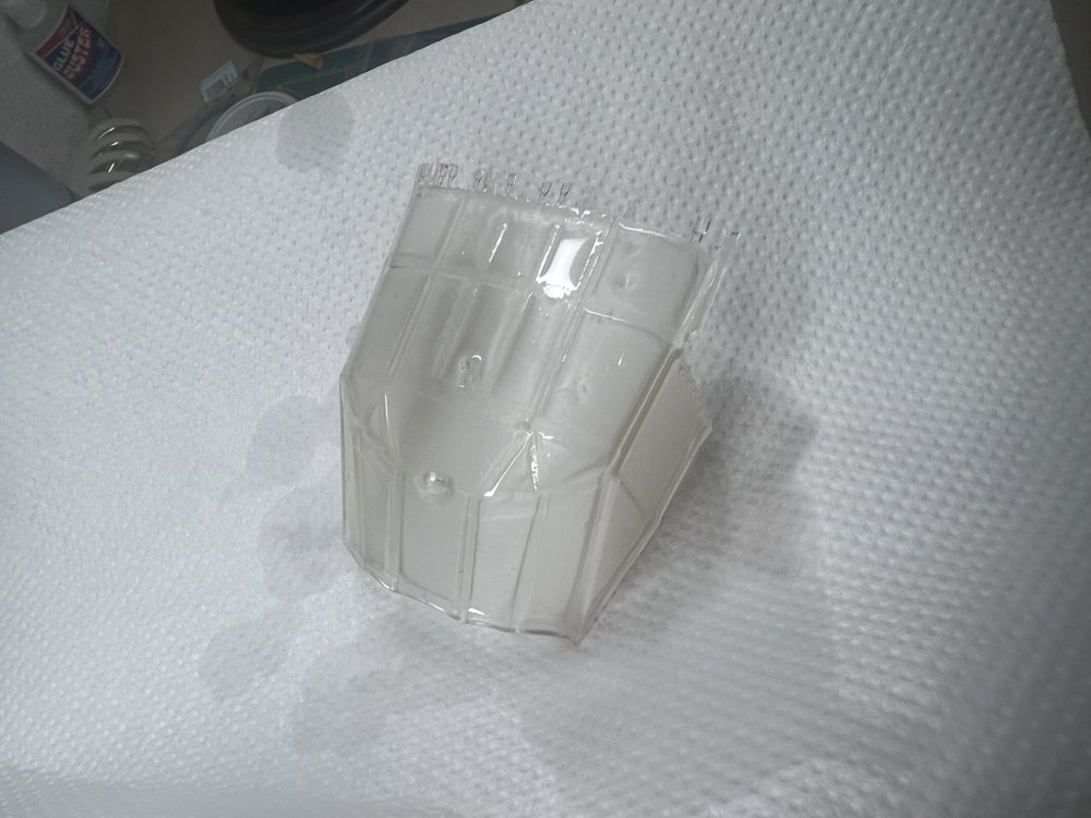

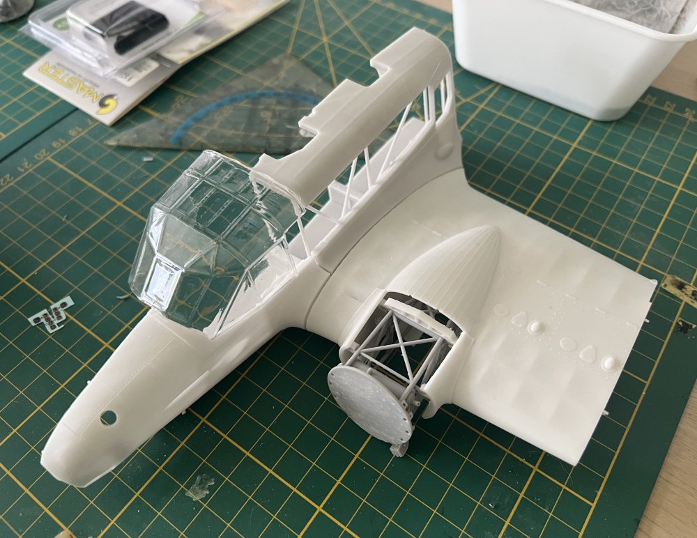

Clear parts

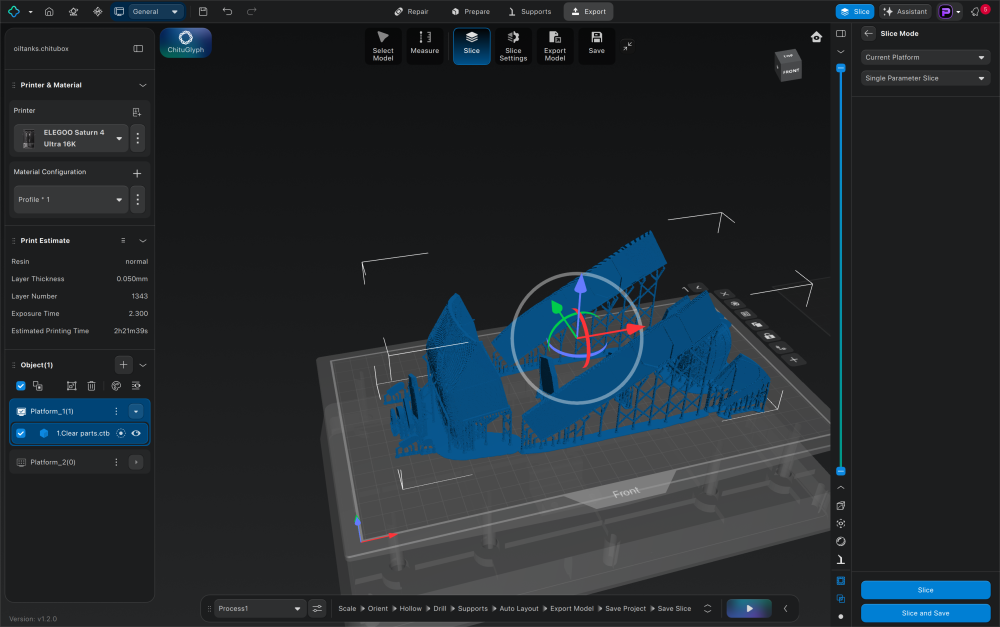

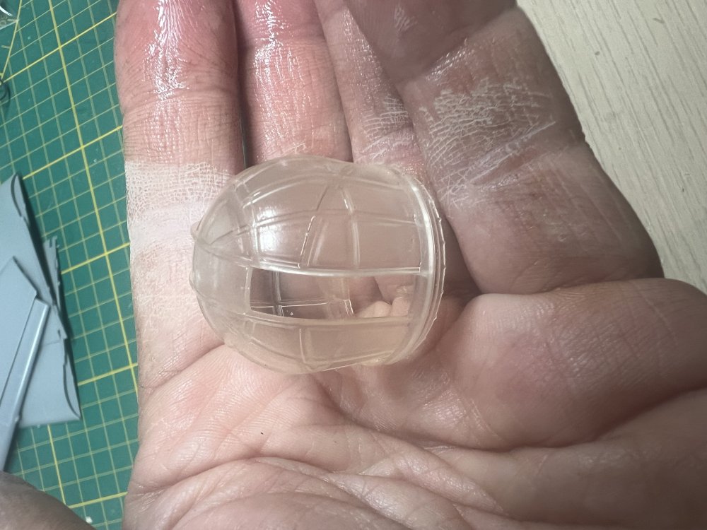

My biggest fear are the clear parts. I've never been able to print proper clear parts. I've tried Anycubic transparent resin with sad results. Now I tried Elegoo transparent resin. I thought it made sense since I print in an Elegoo printer now as well. First I checked all the settings. Mostly Anti Aliasing. I set this to the max (8). That makes the print time a bit longer. 2 hours and 20 minutes.
For slicing I use Chitubox. By far the best in my opinion, after trying several programs. Aladdin Models slices the parts for you. This means you are not able to change the angle of the parts yourself. That is a big downfall, but I understand their reasons.

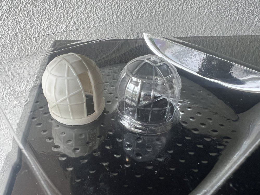

My first results is not very encouraging. Yellowed clear resin. Cloudy, milky. Judge for yourself. I might use these to Vacform my own parts. We'll see!

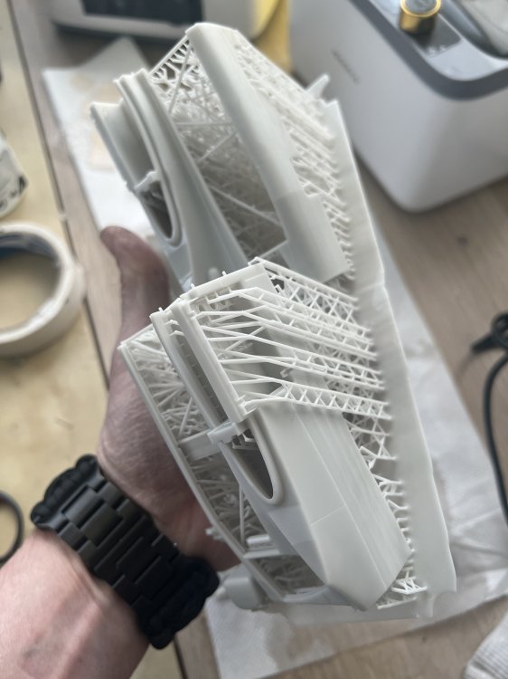

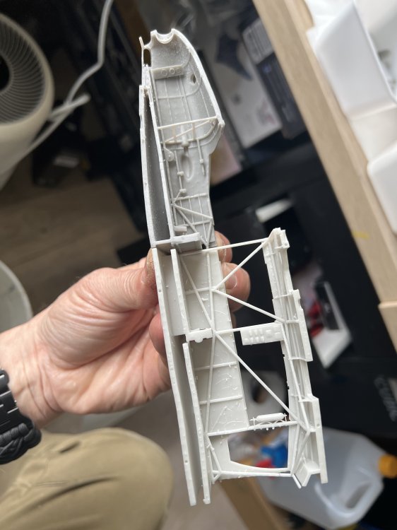

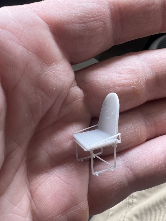

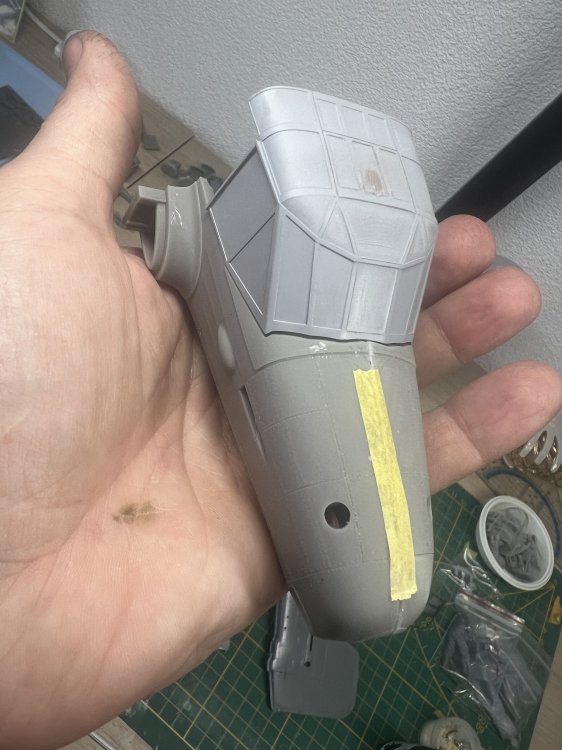

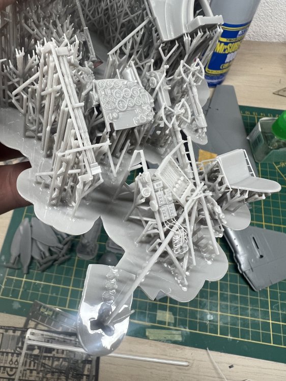

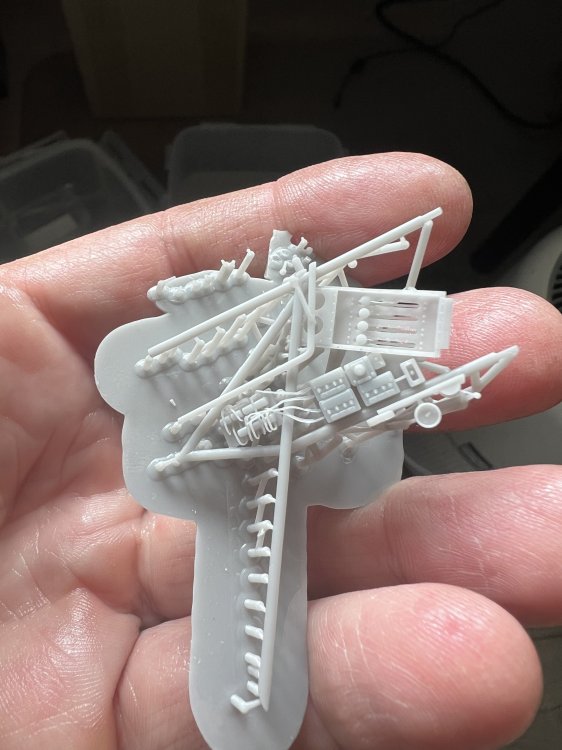

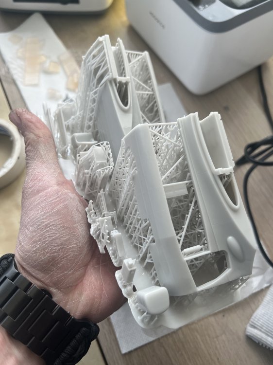

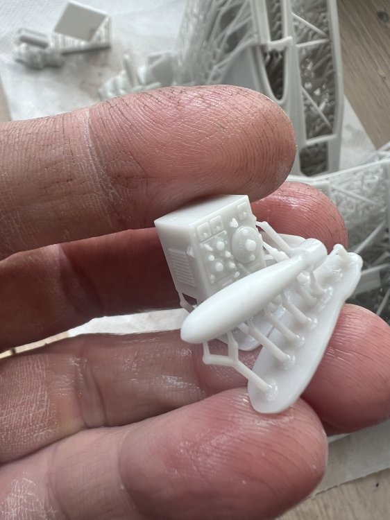

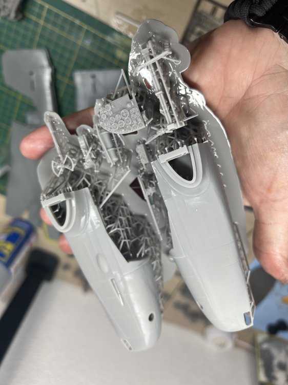

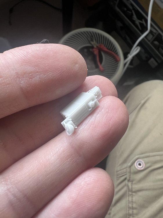

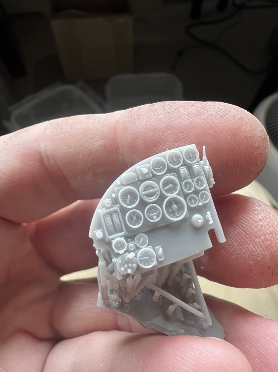

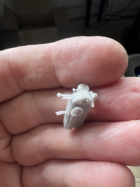

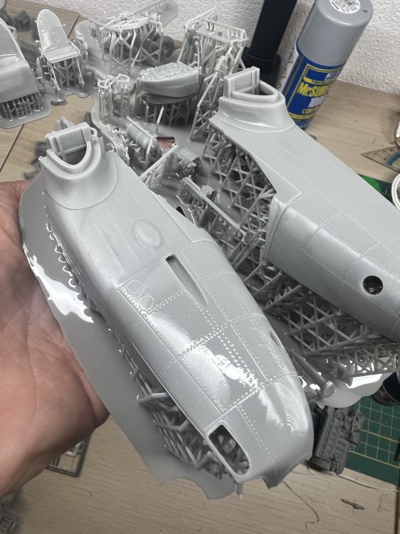

    3 hours of printing and we have the cockpit. The whole nose section with all internal detail. I must say: the surface detail is crisp and complete! And so is the interior. The Elegoo 4 Ultra 16 K has

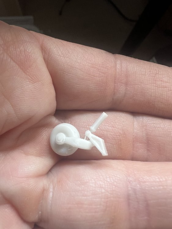

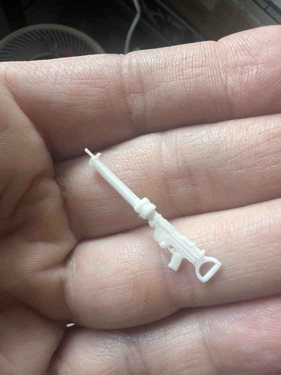

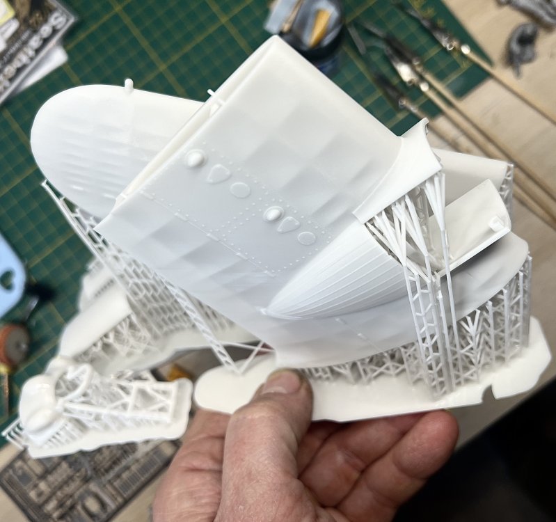

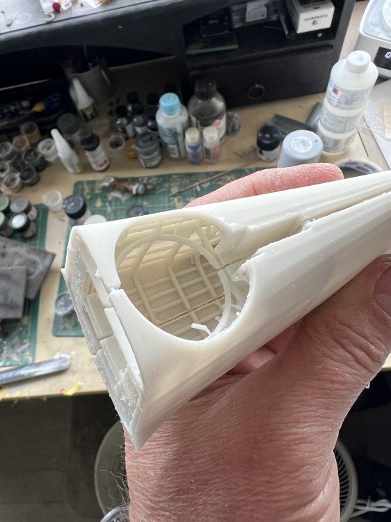

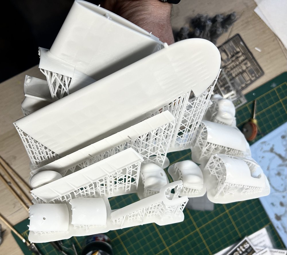

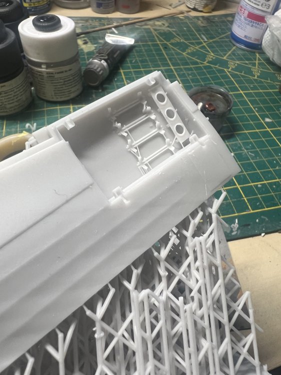

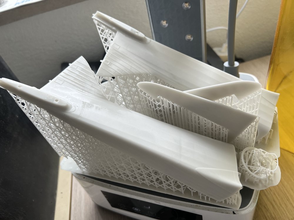

    Another 12 hours of printing and we have the tail and left wing. The detail keeps amazing me. I’ll do some proper shots ater cleanup of the parts.

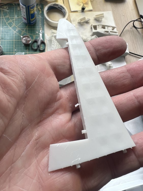

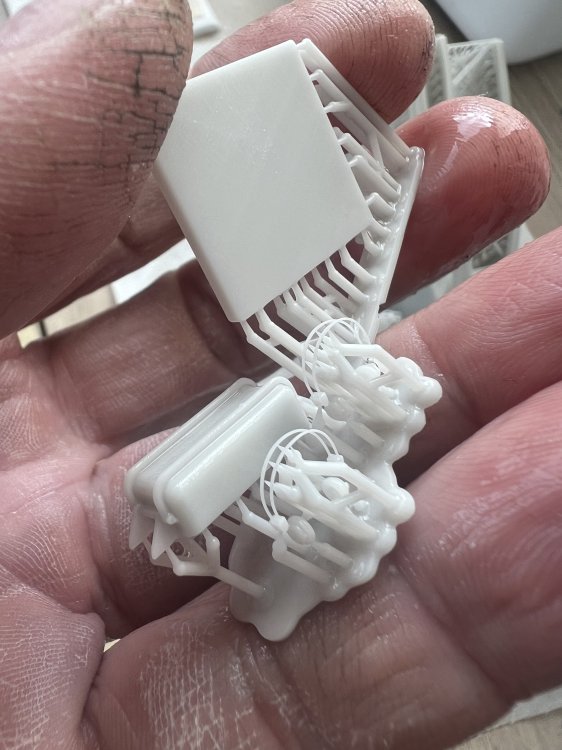

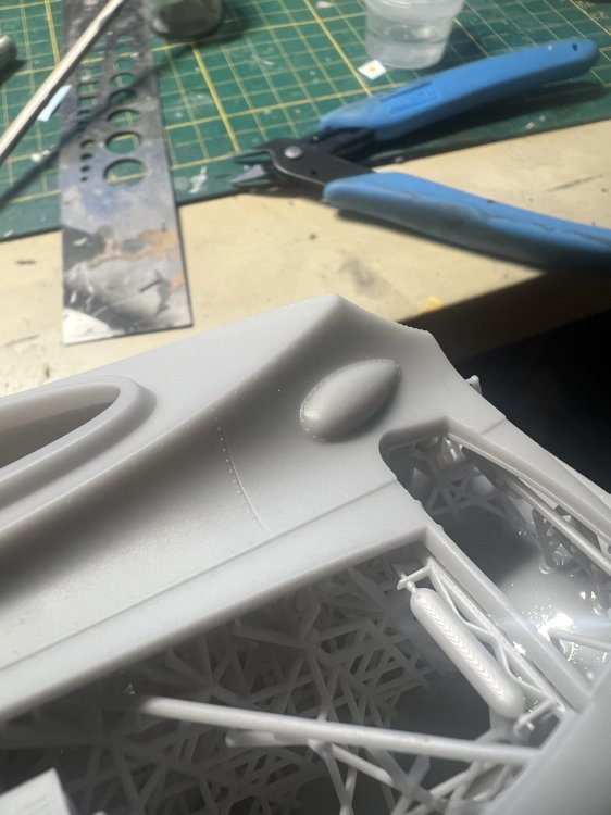

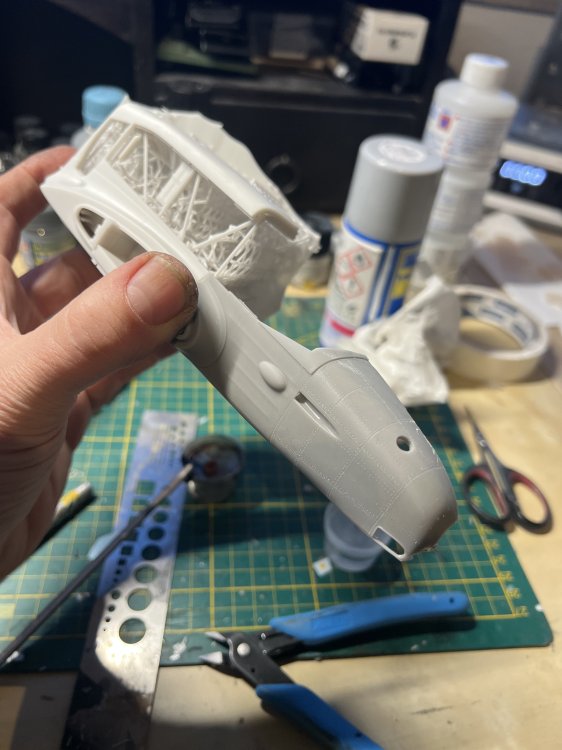

    So. The wingroot needs a little nip and tuck, but once done it’s tight strong fit. I ise this slow drying CA. Perfect when installing the tiny pushrods on the cilinders.

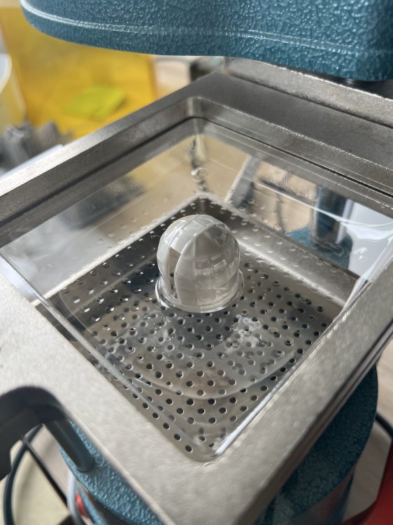

For now i will try vacforming. The Anson was able to open a lot of sliding windows. This will be easier with a vacform canopy.
Sprayed mr Surfacer but will seal it in with Klear. My experience is that the heat from vacforming attacks mr Surfacer…

@FG2Si Carl was able to polish 3D printed F-16 canopy to perfection.
This is the canopy that @Martinnfb mentioned.
The one on the left is as it came in the kit, the right one is after I polished it using various grit sanding sponges and then a dip in Looks Like Glass.
Carl
Indeed it does with most paint, though you could try spraying a very light coat of mold release on it before vaccing. I've had some success with that lately, but it's sketchy at best. The best vac results I've had have been by making a solid mold of the master, then casting a copy in resin, then using that as the vac form. The resin does not stick to the clear poly as bad, especially with a light coat of mold release. I have a couple of test shots I did for the early P-38 conversion I'll be posting soon.
I have not had good results with printing clear parts. Way too much post processing for me. I will soon try casting in clear and let you know how that goes.
I am learning a lot from watching your threads lately!!
I was thinking dipping the whole part in Future. That becomes pretty hard and non stick.

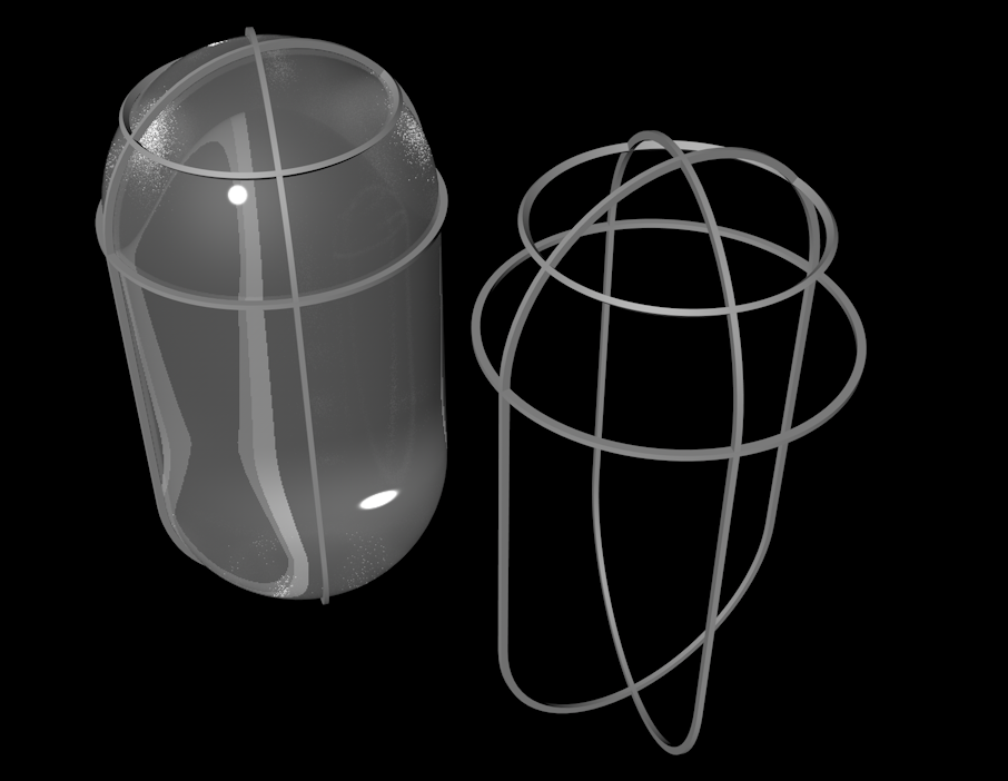

Alternatively, you can try to do a female vac-form mold, by pouring resin, or plaster, ON TOP of the part …
You can then vac-form the part by sucking it in the mold. Plus this allows you the keep a crisp surface detail where it counts: on the « outside » of the vac-formed part. Vac-forming in female molds is initially more complex than vac-forming on male molds, but the quality of the end product is infinitely better, to the point where the molded parts are equivalent to IM ones.
The question is then « Yeah, but how do I manage to have holes in the mold to suck in the air and the heated plastic ? » Easy-peasy : drill some tiny holes in the frames of the master, insert monofilament in the hole, pour your mold material making sure your monofilament sticks out of the outside of the mold, then remove the monofilament when the mold material is set. You end up with a tiny hole though the mold. A 0.5 mm hole is most of the time enough for sucking-in all the air of the cavity and molding the part. You will end up with a small « pip » on the molded part where the hole is, but, if you put the monofilament on a frame, that is easy to get rid of, without adverse optical effect.
HTH
The Elegoo 4 Ultra 16 K has a very strong UV lamp. You can easily drop the lighting time to 1.8 seconds for 0,05 layers.

Well. The elegoo ultra 4 16K should be able to print crystal clear, but so far i havent managed to. Vacform will be my weapon of choice.
