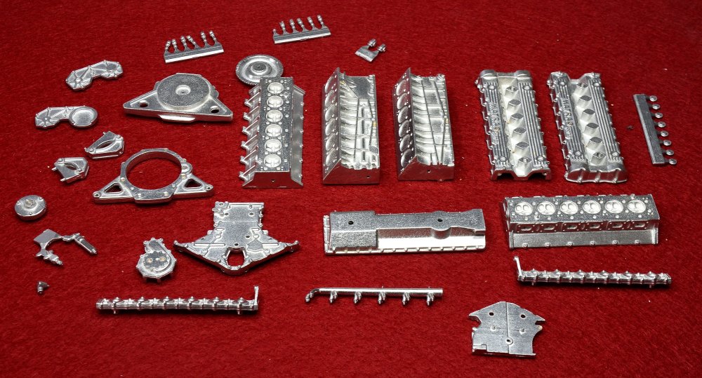

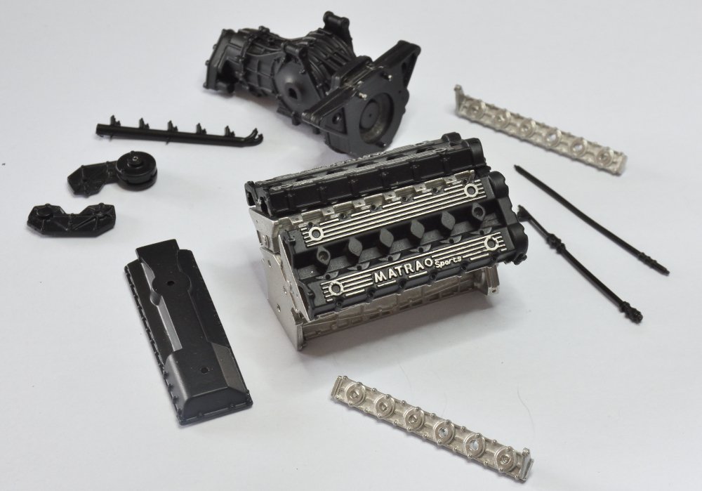

Finding your way round round these models i a bit of s mission at first. Parts are not marked and there are hundreds of them, the answer is to download a parts list from MFH (why dont they put one in the box) so you can cross reference the part to its picture which will give you a part number that tallies with the instructions. All parts will need tidying up and nearly all parts will need holes drilled. These are the basic engine castings, i have already drilled nearly 100 holes in these castings, mostly 0.9 and 1mm which gives you some idea about how the build differs from your average Tamiya kit.
These parts above have also been put through my geologists rock tumbler to take the sharp edges off.

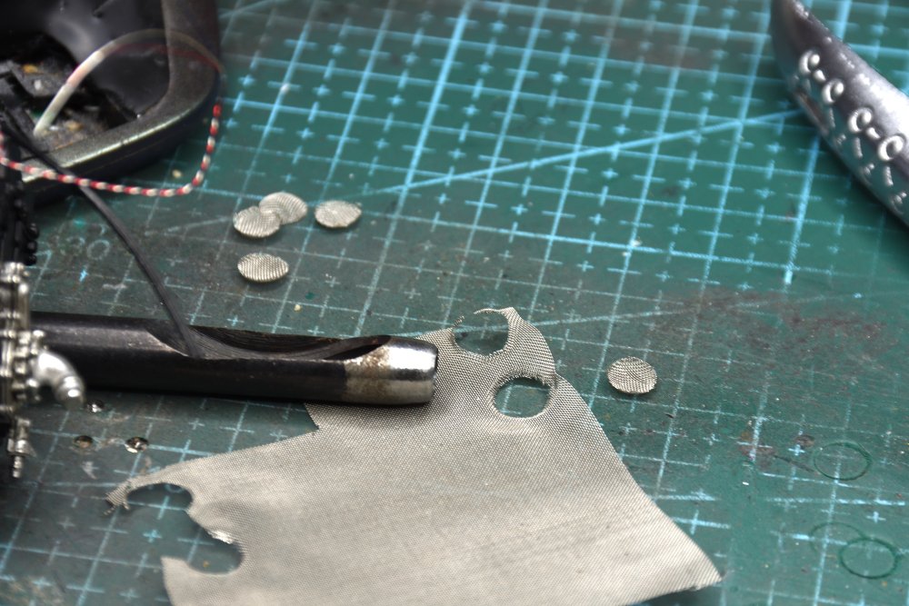

    Well my problem is not making the mesh domes, its attaching them without seeing glue. The kit supplied forming tool sort of works, i superglued the 2 parts of it to some parallel pliers Them pressed

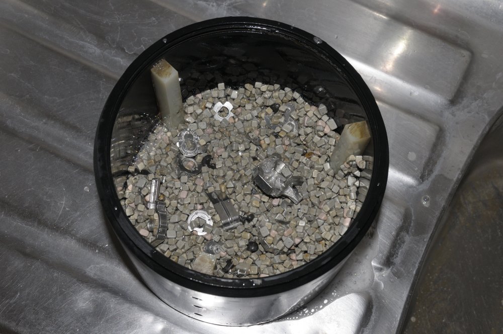

How do you like your rock tumbler? I used one of these types of tumblers filled with tiny steel balls and found the result not optimal. Detail got softened too much for my liking. I invested in a magnetic tumbler and use 0,3 mm steel needles and have far better results, with less loss of details.

I use a rubber barrel with 5mm triangular ceramic chips that are shaped to get into corners. The secret with this system is the more chips you put in the less the parts drop as the barrel rotates and the more water you put in the more the polishing effect especially when combined with washing up liquid. I have a second barrel with crushed walnut shells for finishing. Again trial and error will show about 20 mins is fine for the chips where as the walnut shells can run for 12 hours or more.
This is interesting, maybe, I should test the ceramic chips with my simple tumbler as well. The needles in the magnetic tumbler do a good job, but the finish on larger areas was obviously much better with the steel balls, but tat left the corner problems.

When you have tons of white metal parts to clean, a tumble polisher comes in handy. Of course, there is more cleaning to do on many parts, but it´s a good start and it even hardens the surface a bit like with hammering. With MFH kits, you often can use the sheer metal without painting. When proper done, you can polish it to mirror finish.

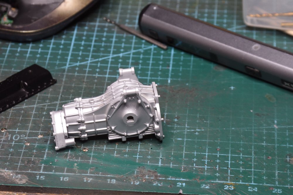

The instructions call out a natural metal finish for the gearbox, i did try this.....DSC_0127.JPG
but it looks really odd against the engine, The gear box is plastic so unlike the metal engine, you cant leave it natural finish. I have checked all the pictures i have but cant find a single one with a metal finish box, they are all black so i am going with black.
I am using a jenolite etch primer which seems to work with Tamiya paints quite well and adding a clear coat to try and make a slightly more durable finish on the metal parts

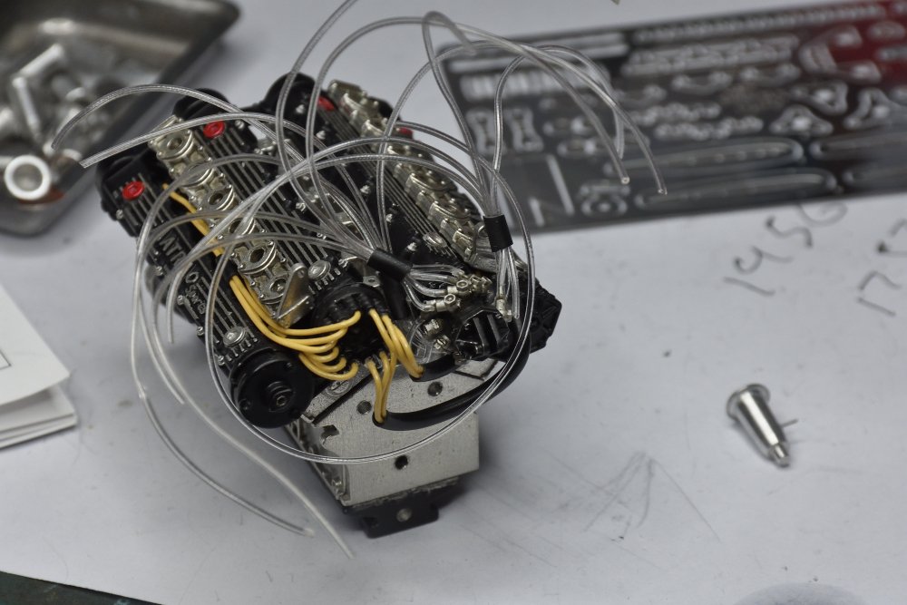

Work here will grind to a halt now as i need to order some plug lead material. The kit comes with 1mm plug leads which are 12mm or near 1/2" to scale so over size. Std these days is 7mm but i would guess in 68 they were nearer 9-10mm being possibly rubber so i need some .7mm leads, strangely MFH do a .8mm yellow lead so not sure why they supply 1mm ? it may not sound a lot but its 20% and does notice.
On car kits, I spray many plastic or resin parts first with metal color like aluminum and then spray heavily thinned Tamiya LP-5 semi matte black on top in thin layers. While drying, the silver starts to show through the black on corners and edges. That effect gives a very metallic look to black parts like gearboxes. It is a bit like dry brushing, but more regular and more convincing to my eye.
The use of 1mm wiring seems odd, I have never seen something that thick on my MFH car builds. The BT52b has 0,4, 0,6 and 0,8 mm wire supplied.

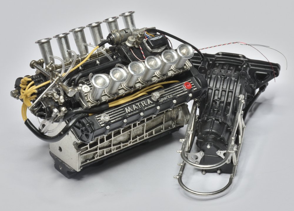

A little bit of artistic licence here as i have tidied up the plug leads, they are correct but they are routed a little different, it hard to find good reference pictures as the heads on most surviving cars are different

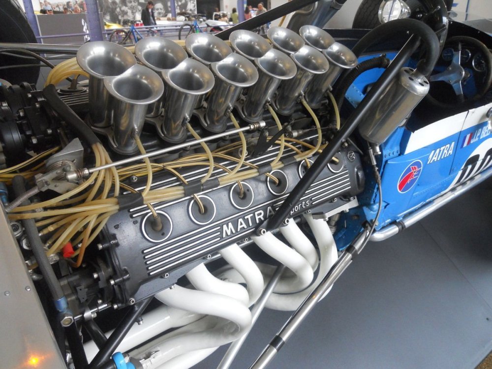

This is a real MS11 in a museum, note the vertical trumpets with the plug leads recessed below the rocker cover and weather proofed with rubber bungs.

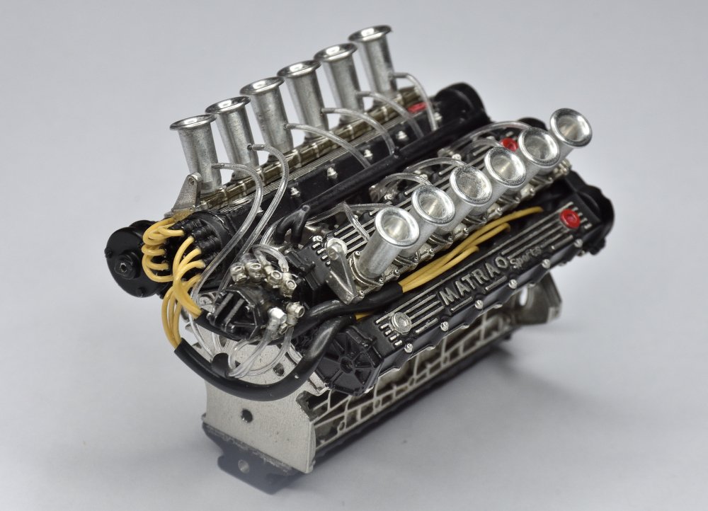

This is my engine with 30 degree trumpets
I found this which relates to detailing the Tamiya version as its relevant if you are looking for details i have put up this link.
https://www.mrof1engineering.co.uk/pdfs/Matra%20MS11.pdf
I think the clear tubes are fuel lines for some form of accelerator pump that dumps neat fuel into the trumpets on a sudden opening of the throttle/acceleration . One of the problems with carbs is they rely on airflow over the jets to lift fuel and if you floor the throttle the air flow increase far faster then the fuel lifts so some for of accelerator pump would make sense but bear with me as i am a bike guy not a car guy.
Anyway this is where i am now.

I think this is as far as i can go with the basic engine minus ancillaries. The instructions say attach the gear box but i think it would be better to have the chassis built up first in case it doesnt fit :-) The engine goes together easily with no issues so far. The secret seems to be getting things straight before you start. For those who haven't built an MFH kit , the white metal is soft as butter. I have built a couple of their motorcycles and was surprised to find their stands could not support the weight of the bike so i have to display them on wooden blocks. That's how soft the metal is.
The following morning this was on its side and the stand had bent over night under the weight of the model :)
My point is nearly every part of any length is bent in the box, even if it doesnt look to bad so getting everything trued up before you assemble is paramount or the further you go with construction, the further out the parts will be, its a pyramid effect.
One small issue i have had is the domed mesh for the trumpets that would stop birds and small children getting sucked in. MFH supply a small jig to form the dome in some mesh but its pretty crude. I struggled with it and the result wasnt really usable IMHO. I did wonder what i was doing wrong but when i looked at the MFH site and their publicity shots of this model they obviously had the same problems as me 🤣. I need to put my thinking cap on.
Anyway this where i am at and i am off to look at the Chassis which i am guessing will not be straight forward. Thanks for looking in ..

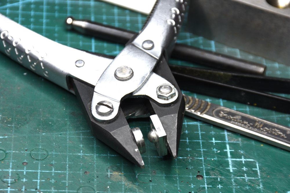

Them pressed the wire mesh between the two , i then used a hollow punch to stamp the bulge in the mesh out from the sheet
it works OK but there is very little to glue here to the trumpet without the glue being rather prominent
