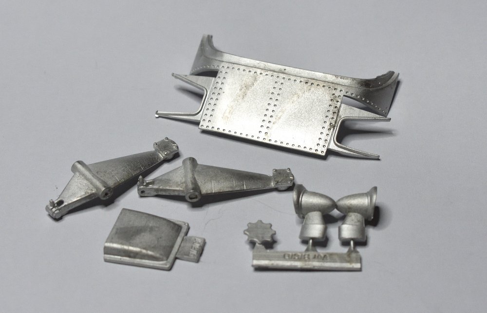

Ok so after a full inventory i am missing a further 19 parts. Interestingly this is everything on metal parts list page 5 which in a strange way is reassuring as opposed to random parts. Lets see if they relace them.
In the mean time i will carry on. fortunately the missing parts all refer to the rear wing and oil cooler which would be the last parts to fit so even if i never got them, without the rear wing its basically Version C instead of version D. :-)

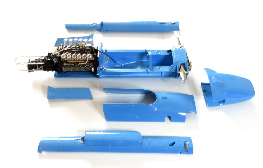

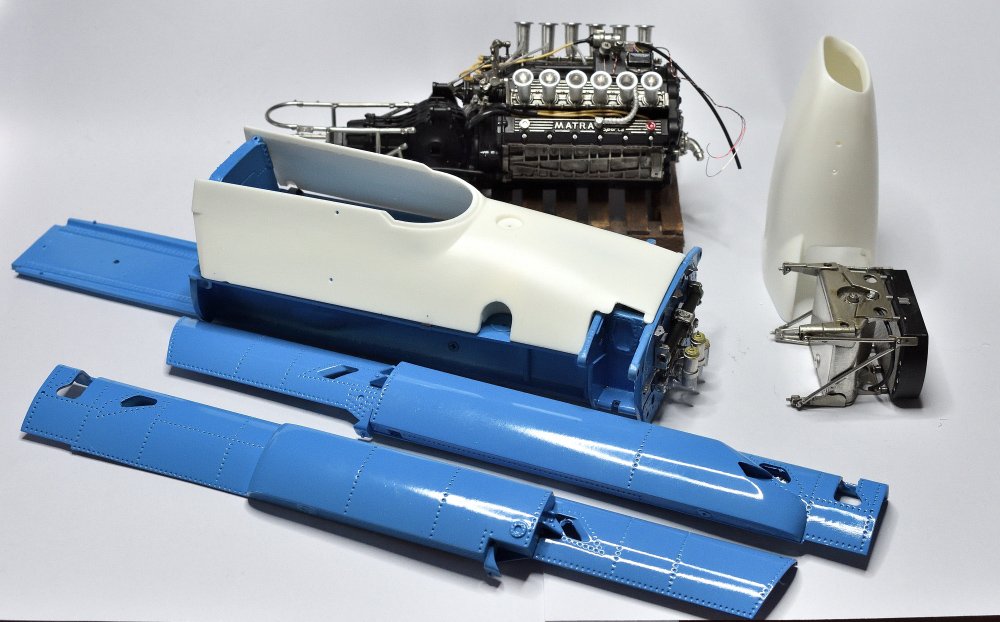

And this where i am at so far. I cant for the life of me see how you fit the cowling and nose cone. I fitted the attachment points and now i am supposed to drill the cowling to suit using a paper template but drilling blind and getting a 0.5mm pin to align with a 0.5mm hole ? basically thats not going to happen 😂
Body parts fitting with MFH kits, phew, a true nerve rattler. I know the connections you speak of, Paddy. In case all parts fit perfectly, I drill one side, insert 0,5 mm brass rod temporarily or a fitting needle, only protruding half a millimeter, dab some pencil or marker on the points and mark the opposite part with that.

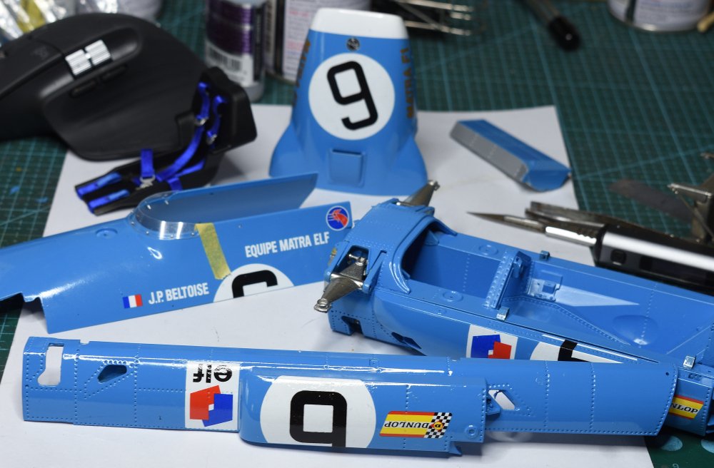

If you are used to Aircraft and Armour its always a bit strange when you need to do most of the painting "before " assembly and like wise if you want to spray clear over the decals you need to get that done before anything else.
Some people like to get a finish on the paint at this stage but i tend to put the finish on the clear, that way if i go through the clear i get a warning of blue on the cloth where as it i polish the blue you get no warning of a primer coat showing before its too late. Incidentally this is rattle can Tamiya "French Blue" over Halfords white primer
Decals next then a clear coat or 6 , it does look like i am steaming ahead here and i supose i am but there is a lot to do with running gear and details, clocks seats screen and so on.

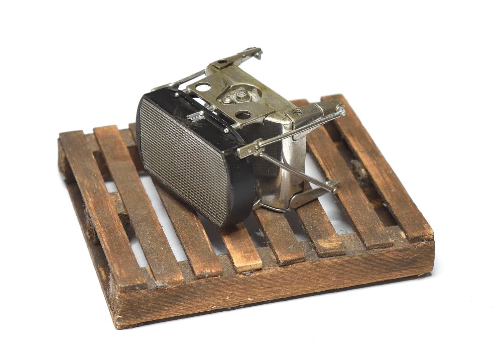

Radiator assembly was delivered this morning on a pallet ..........................from the other end of the work bench 🤣

I now have all the parts so feeling a lot better about this build. Decals are on and top clears applied so once they go really hard i will try and cut the finish back. I have to say the decals are probably the best i have come across. Very thin but opaque so even white doesnt show the blue through. No tendency to stretch and very sticky. Ever since my troubles with some other decals where the guy said i was applying them all wrong and washing the glue off, i have dunked the decal in warm water for 5 seconds then removed it and allowed the decal to release itself after a minute or so ,so its not possible for the glue to be anywhere other than on the decal and its made a huge difference to the job. That said, i did paint the white band round the nose as i couldn't see that really working with the supplied decal.

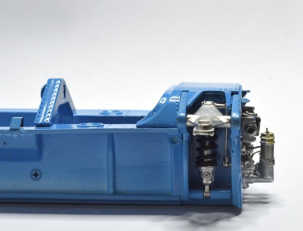

I have got some of the rear drive on the left here. it took me hours as the hub is basically held in its position by 5 suspension arms that all converge on the stub axel . The trick will be getting the other side symmetrical to this side . Everything is very bendy at this stage but once all 5 arms are in position the whole thing becomes quite solid. A small bend on 1 part does throw the whole thing out.
  • Author
all in all that worked quite well but the secret with these kits seems to be getting the parts spot on as you go or the further you get, the more creeping errors will catch up with you further down the line. Also dont expect anything in the box to be straight. The drive shafts here were a few degrees out but over their length that throws everything else out as well. The bottom tie rods are also critical and however carefully get them to length it makes no odds if you drilled the holes for them to deep or too shallow or at the wrong angle and both those dimensions are for you to work out so dry builds ahead of any glue are again essential.
