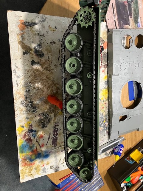

Posted the start of this on the old forum, before it went down. The intention was see if this kit could be made into a working RC tank. All while trying to retain as much as the kit as possible. I first investigated whether a propitiatory lower hull could be used, but this would not have been correct, so was dismissed. This would have been an easy solution, but why make life easier? I assembled the hull as per the instructions, after installing bearings for the suspension. Inner and outer bearings were fitted for the torsion bars to pivot on. A test assembly of the swing arms showed that, by using a metal cold weld product, a solid mount could be made to mount the torsion bar on the swing arms. Inside the swing arm, is a captive nut to hold the wheels on. Two bearings and washers were used on each wheel station, to give a nice smooth ride.
