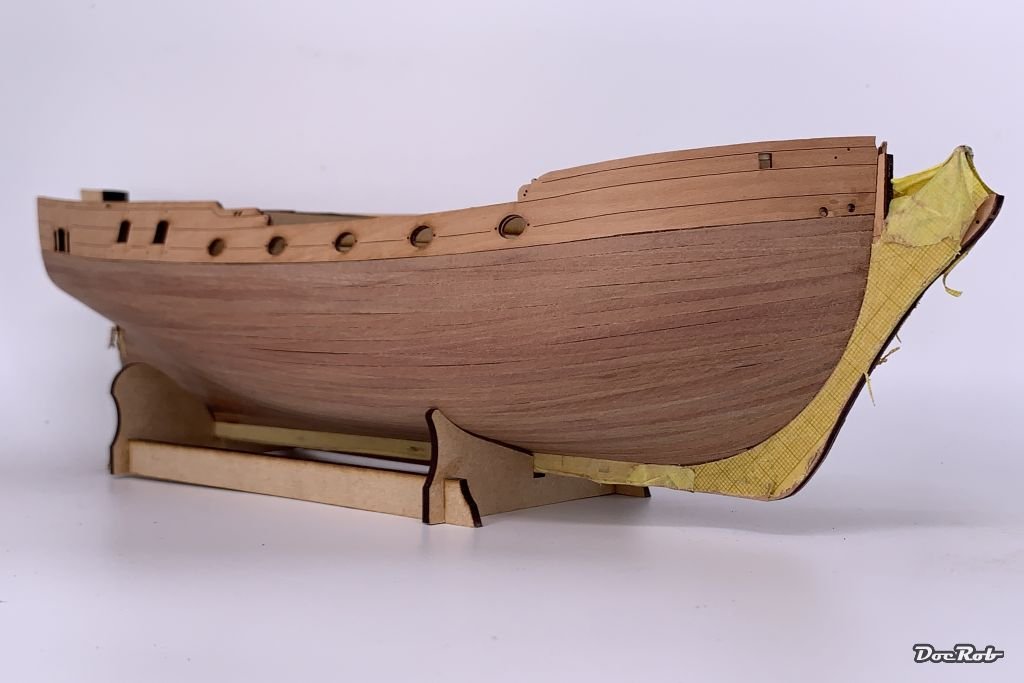

This build has been started some years ago. The reason, I post it again are twofold, one reason being to add another aspect of modelling to LSM Mark II and on the other hand to motivate myself to finish the build, which stalled with rigging. The name giving Duchess was a very interesting person, to say the least. In her later years, she owned the ship of the same name as a yacht, cruising the Atlantic, the Mediterranean and the Baltikum in it. Elizabeth Pierrepont, Duchess of Kingston-upon-Hull - Wikipedia The kit is made by Vanguard Models, who´s owner Chris Watton designed it to historical correctness. It is a fantastic kit, addressing experienced builders, which I´m not, I have to confess. In fact, it was my first serious attempt in building a wooden ship. I found the experience extremely satisfying, and I propelled through the build in about five month and learning to know the completely different world of working with wood scale wise. There were challenging parts, but nothing proved unsolvable and the precisely prepared kit helped a lot I had a build log in the old LSM and will only show some of the important steps of the build. I do not have the old text, but feel free to ask, if you are interested in details about the build. The box art of the beautifully decorated ship: I started with the framing, which proved very sturdy and was a good base for planking, in this case double planking: After adding the false deck, I applied the bulwarks, which needed to be pre formed with water and heat: The first plank was installed: First planking is done. If I remember right, the planking was done with limewood planks. The bulkheads were bevelled, to accept the planking. Here, I added the stern gallery base parts and the rudder: Second planking was done with the supplied pear wood strips. As most of the hull will be left unpainted, I pre selected matching planks beforehand. To speed up the planking job, I used CA glue for that, which may not be the classic approach, but worked for me. So far for now. Cheers Rob
